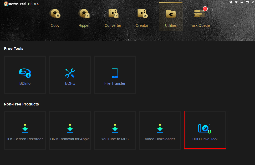

- Connect the UHD drive to your computer.
- Launch UHD Drive Tool from DVDFab 11 -> Utilities.

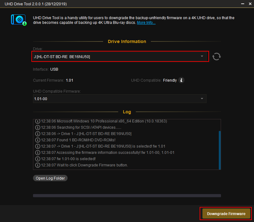

- Choose your UHD drive which need to downgrade the firmware, then UHD Drive Tool will access the firmware information from server.
- Click Downgrade Firmware to downgrade the firmware for your drive.
NOTE: Please don't disconnect the drive or Power OFF the computer when downgrading process ongoing!
