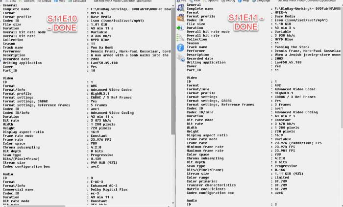

If you'd like to see this for yourself you can download episodes 10 and 11 from season 11 of NYPD Blue from Hulu. I was in the process of downloading this show when the DRM change happened. There were a handful of episodes that wouldn't originally download out of the series. Once StreamFab was updated to resolve the issues downloading from Hulu I was able to download the remaining episodes except that they took much longer during the Parsing stage and the frame rate on the resulting files was choppy and made the episodes unwatchable (a problem which still hasn't been fixed). If you download these two episodes now you'll see that episode 10 goes into Processing once the video and audio are downloaded and only takes about 30 seconds to finish. Episode 11 goes into Reencoding instead and takes about 5 minutes to finish. I added screenshots of both so you can see the difference in language used.

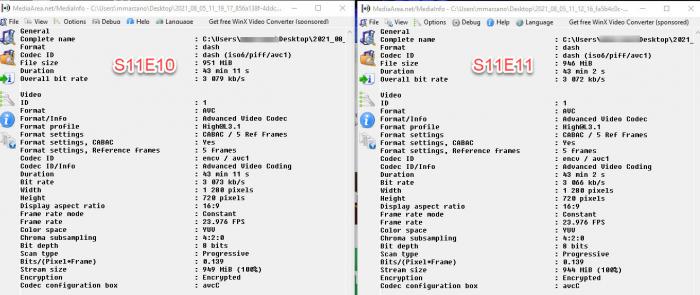

Here is where it gets odd... I pulled the VIDEO files for both episodes from the TEMP folder when download was done, but before StreamFab reported the episode was DONE. These are the raw videos as downloaded BEFORE any processing, re-encoding, or remixing was done. There is no audio in these files yet.
NEITHER file will play, no matter what video player I use.
From what MediaInfo shows, the video stats on both are identical, other than the bit rate, which is understandable for different videos.
AFTER both are done here are the stats of the final output MP4 file...
It looks the same as what you posted.

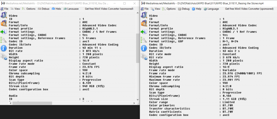

Its obvious on S11E10 the Video was NOT touched (all video parameters match),
it was NOT re-encoded. However S11E11 it was (bit rate is different, variable frame rate, and a few other added parameters now show).
