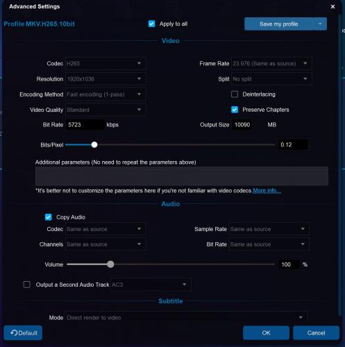

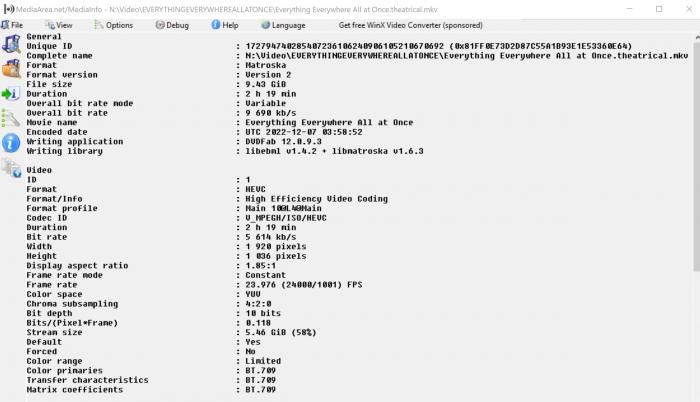

FQs19 So I just tried ripping the first chapter of the bluray disc of Everything Everywhere All at Once (2022).I used the Profile DVDFab selected without adjusting any of the attributes for that profile. Unfortunately, I still couldn't get just the 1st chapter to rip by itself. DVDFab will always rip the entire title no matter what I do. Here is the Mediainfo from this bluray rip showing the whole movie, 2hr 19mins:Why will this not work for me??I really need this feature to work. I'm wasting energy and time trying to make sure what Subtitle works when I choose the Subtitle Direct Render option. Please help.I've attached the logs again. Not sure why the attached logs aren't shown on the post.

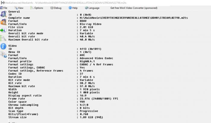

FQs19 I switched to using the Copy module instead of the Ripper tab just to see if that would only copy the first chapter and guess what, it worked! It only copied the first chapter. Here is the Mediainfo file for proof:It shows only 7min 4 sec!So there is definitely something wrong with the Ripper module.@MonaCould you have someone look into this?I'm attaching the logs from this session, but you'll see in the logs that I tried a whole bunch of different tests.Thanks

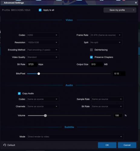

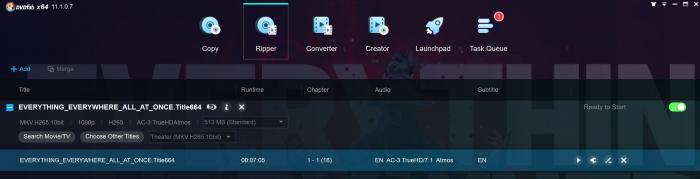

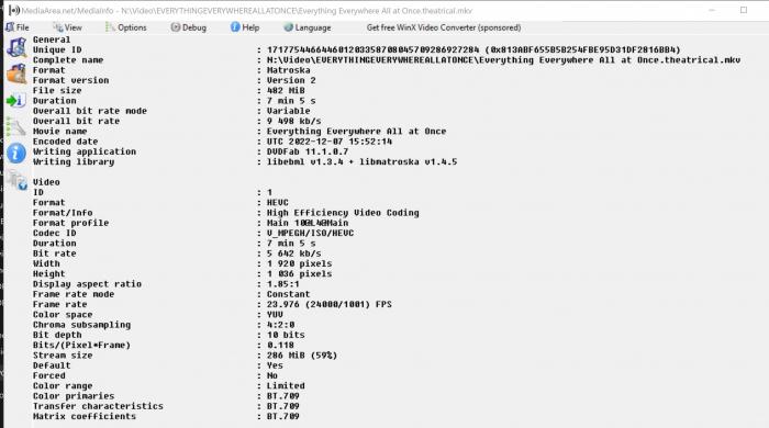

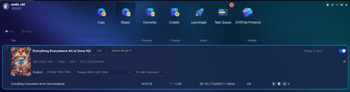

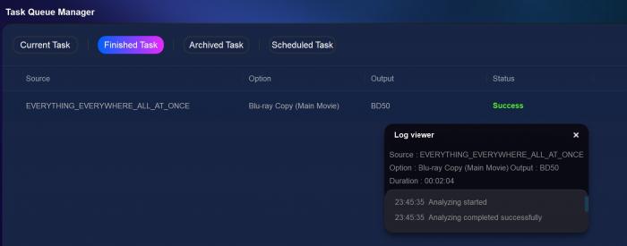

FQs19 @Mona I uninstalled DVDFab 12 and installed DVDFab 11.1.0.7 to test @october262 theory about DVDFab 12 being the problem and he was correct. I can not rip a single chapter or multiple chapters in DVDFab 12 (any version in 12.x.x.x). I can, however, rip a single or multiple chapters in DVDFab 11 (tested version 11.1.0.7).So there is no problem with my computer. There are no problems with any of the Profiles I use.There are no problems with any of the video attributes I change in the Profiles I use, like 2 pass and custom Bits/Pixel, etc.There is a software problem that occurred going from DVDFab 11 to DVDFab 12. I don't have time to test every version of DVDFab 12 to see where chapter selection ripping breaks, but at least your software developers can look at the code between DVDFab 11 and DVDFab 12 to see what changed. Here are screenshots and the logs from my rip of Everything Everywhere All at Once (2022) bluray disc chapter 1:You can see DVDFab 11.1.0.7 was used and it only ripped the selected Chapter 1. Took less then 3mins in my system.This is expected behavior. I'm really hoping your developers can figure this out and put out a new version with the fix. Thanks
