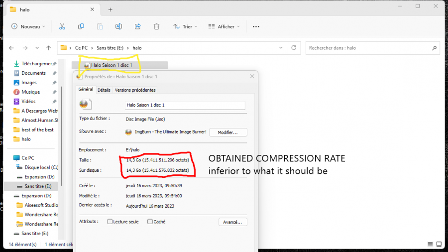

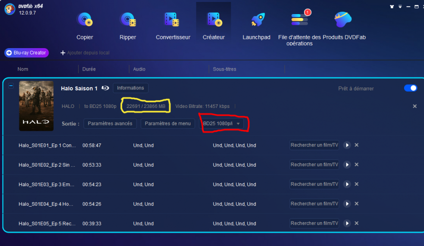

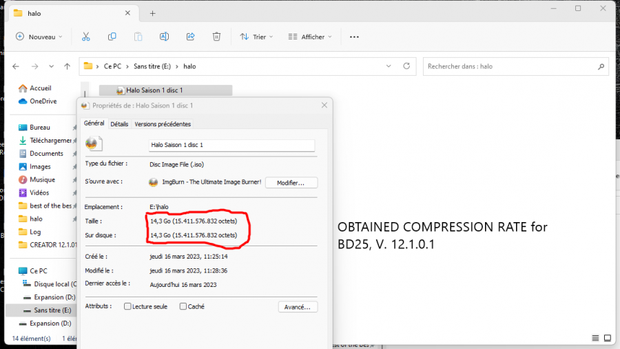

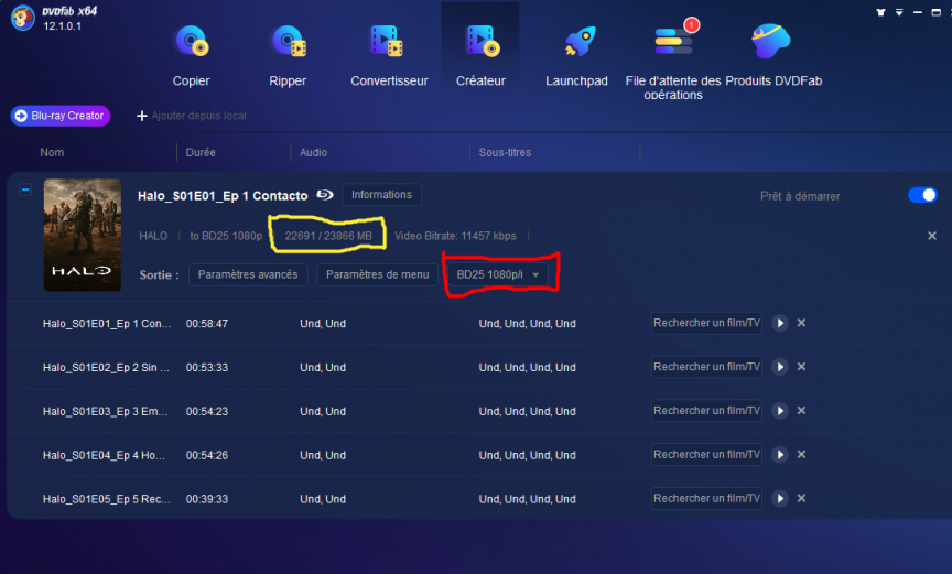

joseg I'm using windows 11. When making a BD25 from MP4/MKV files coming from StreamFab or other sources and applying the compression creator shows the expected compression rate. Once the conversion is done, in my case to BD25, the ISO final outcome is compressed much lower than onnounced.In this case Creator says: 22689/23866 MB but after conversion the ISO file has only 14.3 GB.I have the same issue with all the creator conversions.As an example, I'm sending you for the same files, the outcome using the latest DVDFAB version 12.1.0.1 and downwards version 12.0.9.7.Version 12.1.0.1:Version 12.0.9.7Enclosed in a 2nd message the internal logs for the latest version 12.1.0.1. and a previous version 12.0.9.7.Conclusion: Using whatever Creator version the compression rate is much lower than what it should be. Can you please help?Many thanks,
joseg Thank you Mona.My point is that the obtained BD file is less than what it should be. In this case DVDFAB içs saying that the final file should have 22691 MB but when the process has finalized it only gives 14300 MB. Compression is too high and not what it is said (22691 MB). Previously this was respected. I wonder if it has to be with Windows 11. The idea is that the compression is adjusted to the maximum possibilities of a BD25.

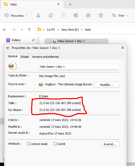

joseg Dear Mona, I just changed in common settings disabling all GPU codecs from AMD to software as per below and now the final resulting file has the right size (23136 MB)[ATTACH=JSON]{"data-align":"none","data-size":"full","data-tempid":"temp_30423_1679061667323_623","title":"screenshot20230317145126.png"}[/ATTACH]Ideally this result should also be obtained with GPU codecs enabled.Is it possible to correct this?
