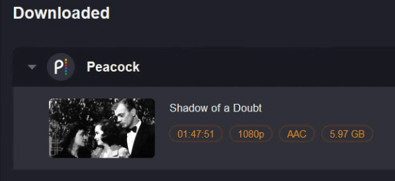

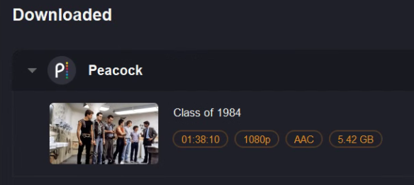

The sad kitty shows up if I'm in the process of downloading from Peacock. Therefore, I've adopted the habit of always adding to the queue until I've finished selecting the shows I want to download from Peacock.
If the endless analysis starts and continues, I'll quickly check StreamFab "Home" to make sure Peacock hasn't signed me out. That is almost always the case and signing in will often quickly stop the analyzing and download the selected show.
