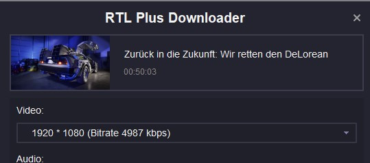

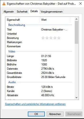

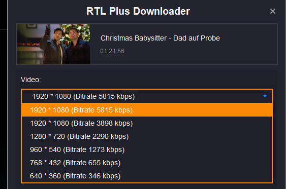

It must be checked whether it is due to Streamfab or whether the videos actually only have this bit rate. I paid for it too. :-) The result of the file is even lower. She only has around 3xxx. The same problem was also checked on Max a few days ago. It was also about bit rates, which were suddenly much lower.
I even have a series that only wants to load 720p. Although it is actually supposed to be available in 1080p. So there must be something hidden.

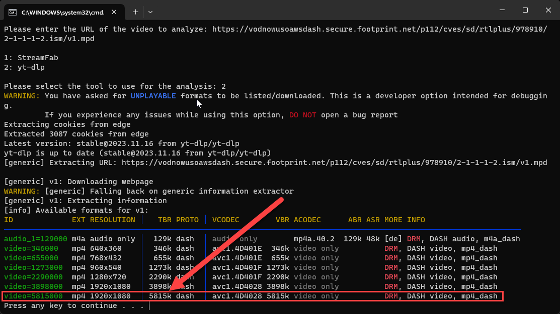

As for knowing if it's a StreamFab issue or the site just changed their encoding settings, you can look inside the manifest file with a text editor.
For users who don't know how to find the manifest file, download it, open it and format it in a "readable" format, you can use the YoutubeToMP3Process.exe to list the available formats.
Here is how to do it:
In a
Chromium based browser, install and enable .
Go to the media you wish to analyse and play it.
The icon for The Stream Detector will show a number for the amount of manifest and/or external subtitles it finds
Click the icon to open the dialog
Right-click the filename and copy the link
On your PC, open a command prompt and navigate to C:\Program Files\DVDFab\StreamFab\YoutubeDL
Run the command:
YoutubeToMP3Process.exe --allow-u -F TheURLYouCopiedFromTheStreamDetector
This will list all the formats available for that video, based on that manifest file.

This file will let you pick if you want to analyze it with StreamFab or with yt-dlp. You can try with yt-dlp if StreamFab is using an older version of yt-dlp or if you need to be logged in to access the manifest file. It defaults to using the cookies from edge but you can switch that to chrome or firefox if that is what you are using to log into the website.
For the yt-dlp to work, it needs to be in your PATH or you can point directly to its location by editing the above code.
