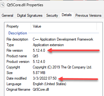

I agree the culprit is an out of date Qt5Core.dll file. For me, though, it seems that the install would have updated it had something else not been preventing it.
I tried Jack’s method, but when I got to reinstalling version 6.1.4.9, my Qt5Core.dll File Version (5.12.4.0) and Date modified (3/3/2022) had not changed, so I suspected something was preventing the update.

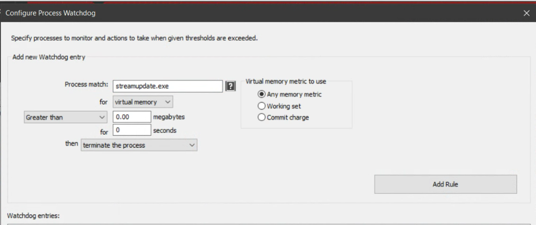

On a whim, I tried to delete Qt5core.dll -- I know, reckless and not advisable, but it did tell me could not delete because it was in use by another program. The program was StreamUpdate.exe.

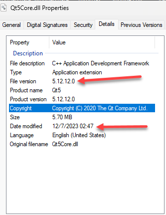

Somewhere along the line StreamUpdate.exe got stuck and was always running, once I killed that process and reinstalled 6.1.4.9, the File Version (5.12.12.0) and Date modified (11/9/23) had changed, which is correct.
I then offline installed 6.1.5.3 overtop of 6.1.4.9 and only the date changed (12/7/23 – release date of 6.1.5.3).

Qt5Core.dll for StreamFab is located here, scroll down to it right click it and pick Properties to check File Version and Date Modified.

- Open Task Manager
- Look for program StreamUpdate.exe – was preventing any update to Qt5Core.dll for me.
- Right-click End task.

File Version should now be 5.12.12.0 and Date Modified should be 11/9/23.
Not sure this step is really needed. May just be able to reinstall 6.1.5.3 overtop of 6.1.5.3.
- Offline install 6.1.5.3 overtop of 6.1.4.9 (or 6.1.5.3 as mentioned above).
- Check that File version is still 5.12.12.0 and Date Modified is 12/7/2023.

I guess I'm going to check Task Manager for StreamUpdate.exe and kill it before I do any future updates.
