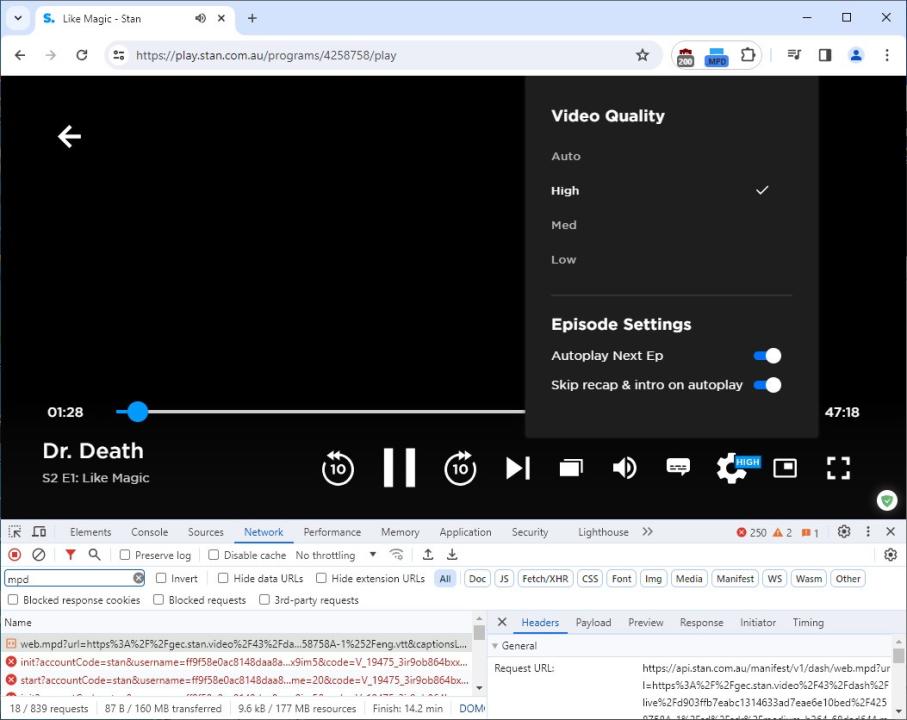

I was hoping that you had subscribed to Basic. That would have made it easy, since that is only SD. In looking over your log, I see nothing obvious. All looks set for a 1080p download on both shows, but that is not the result. The log is not complete, though. It is missing its beginning, and possibly some of its end. I need the beginning, especially, as it shows your settings. Could you please delete StreamFab's Log and Temp directories and then try again with the same downloads? Then attach the full StreamFab.log. Thank you.
One oddball idea I have in my head, which I'll have to consult with someone else about, is that both of these shows are Universal productions. On some streamers, Universal movies, by contract, are limited to 540p. I don't know if that extends to Universal TV shows on Stan. Probably not, as I've never seen that anywhere else in the world, but I'll have to check.
