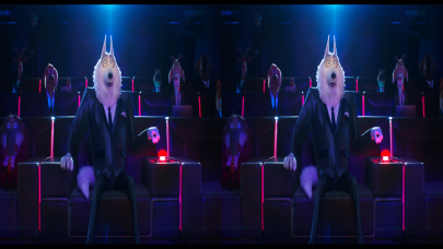

88fingers0 After several attempts i am unsure how to achieve side by side results..all rips come out twice normal size but are crystal clear...should the resulting mkv not be blurry indicating that it is ready to be viewed with active glasses ..attempted with fab 12 and 13...what am I doing wrong..where do I find settings for side by side?

88fingers0 Thanks Wemikna with your help I was able to achieve a side by side file...( see pic ) but results might be iffy. Like with the photo you attached.. my monitor is also horizontally challenged. ( meaning the image appears stretched vertically) does this require adjustment of the resolution width /height or does the movie look correct once played on a 3d device 16x9 with active glasses ? Again thanks for the assist getting me this far...I was only able to achieve this by using fab 12...for the life of me I could not find the settings using 13.
-Blaze\ Sbs images are supposed to be stretched vertically. The left and right images should be exactly 1/2 their original width so that they both fit inside 1 16:9 frame. Then when you turn on SBS mode on your 3D display, it stretches them back out. This is to maximize the amount of resolution you wouldn't otherwise get if it just scaled both frames down at a 1:1 ratio and put massive black bars in the unused space. Hope that makes sense.
-Blaze\ The images I posted are from DVDFab 13 but I just tested SBS rips with it and its still broken unfortunately. DVDFab 12 it works flawlessly but in 13 its not resizing/stretching the frames properly, so 12 is going to be your best bet for now until the StreamFab customers are happy again and they can spare some time for the niche features of DVDFab that some of us still use.
