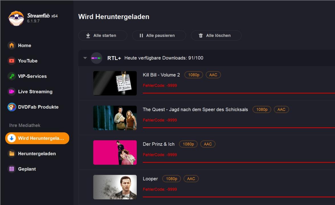

.. the error exists because you select subs.
The problem is that "RTL Plus Downloader" assumes that the subs have as many segments as video or audio.
But this is not the case, as the subs usually end before the credits.
The error is not caused by SF, but by the RTL+ manifest ..
.. behaves the same with every MPD downloader.

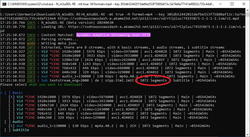

Example Looper - it shows 1072 segments for video, audio + subs:
but there are only 979 segments for the Subs - manually Log
N_m3u8DL-RE can fix this with "--check-segments-count:false"
