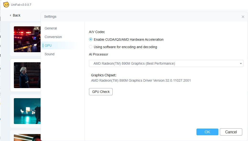

jbinkley60 I am running UniFab 3.0.1.0 on a Windows 11 machine with a Radeon 890M GPU. UniFab crashes on startup and shuts down after the license screen. If I go back to UniFab 3.0.0.7 it works fine. I can provide logs, if needed. Here's the GPU info from 3.0.0.7.Thanks,Jeff

jbinkley60 Still failing on 3.0.1.2. I tried uninstalling and reinstalling, same issue. i went back to 3.0.0.7 and it is fine. I've attached the last portion of the log so you can see the errors. I've added the qefab log which possibly points to the AMD 890M graphics card not being detected properly.Jeff
jbinkley60 I loaded UniFab 3.0.1.3 on an old machine I have running Windows 10 with an nVidia 2080 video card. It loads and runs fine. It won't run on my Windows 11 machine with the AMD 790M graphics card. 3.0.0.7 runs on both.Thanks,Jeff
jbinkley60 Version 3.0.1.4 is a winner on my AMD 890M system. UniFab now loads again without crashing.Thanks,Jeff
