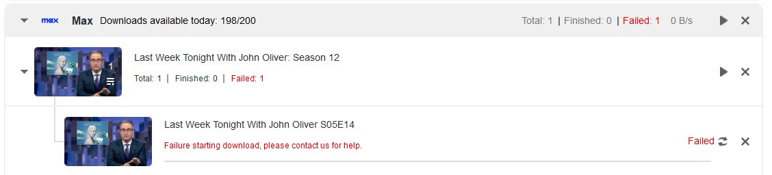

Should note that I had to select MAX as the tab twice in order to get it to open.

Here's a fresh log with just Max and AAC selected. It failed, too.
[code][Info]: "[DownloadControlMax]" not found select audio track :
[Critical]: "[DownloadControlMax]" SelectAudioStream failed
[Critical]: "[DownloadControlMax]" **** match stream fail.
[Critical]: "[DownloadControlMax]" **** GetDataAVS failed.
[Info]: SetErrorCode force - errorcode :213 (will change to :213)[/code]
So AAC selection has not changed anything. So it looks,
as if this is only the first thing SF tries to download.
As a result, SF aborts before trying Video and Subtitle.
In this log only gcp.prd.media.h264.io is used ..
