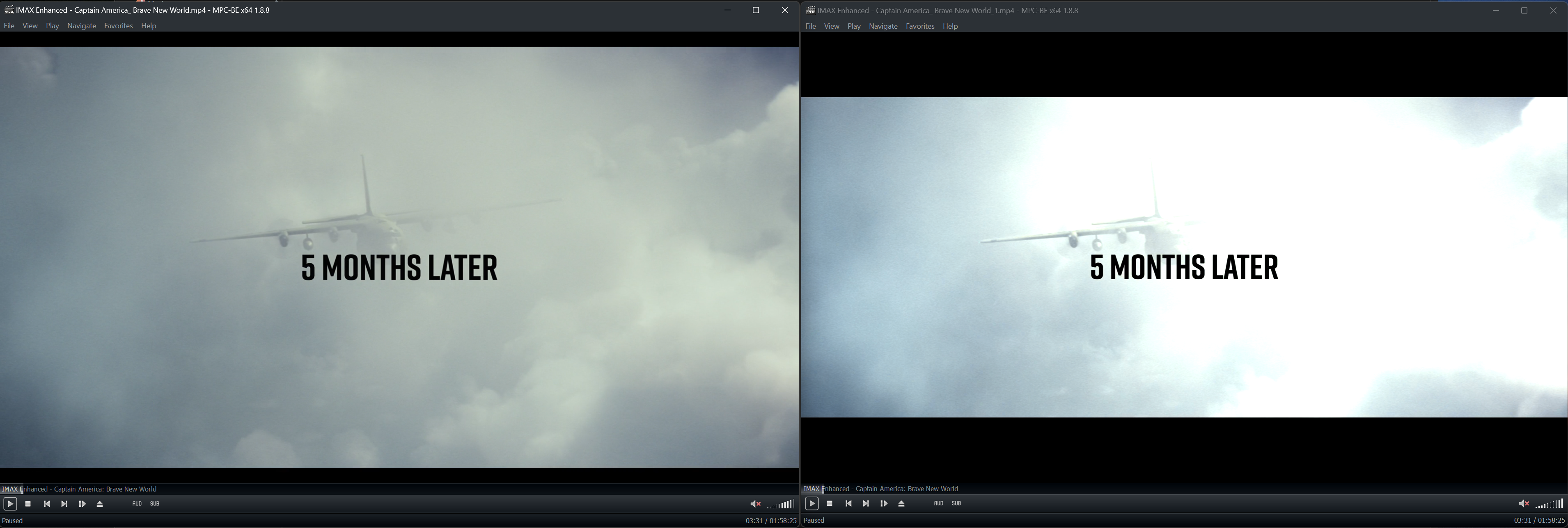

Here is an example with Brave New World at the same time. The one on the left is the working H264 1080p file and the one on the right is the H265 4K DV file. Both are supposed to be IMAX Enhanced at this scene but only the left one is.
