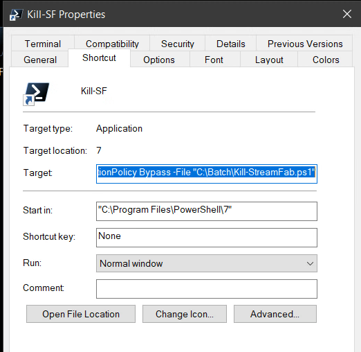

Based on your post at https://forum.dvdfab.cn/d/470957-streamfab-not-truly-shutting-down/16, I decided to take your “crappy temp fix” (as you called it) and expand on it. Using a combination of Gemini and Copilot, I came up with this PowerShell script, which I named C:\Batch\Kill-StreamFab.ps1. All the addresses found in the script can be changed to whatever suits you, such as the log file path and notification wording. Of course you can set up a desktop shortcut using the target line as “C:\Program Files\PowerShell\7\pwsh.exe” -NoLogo -NoProfile -ExecutionPolicy Bypass -File “C:\Batch\Kill-StreamFab.ps1” as shown below.
