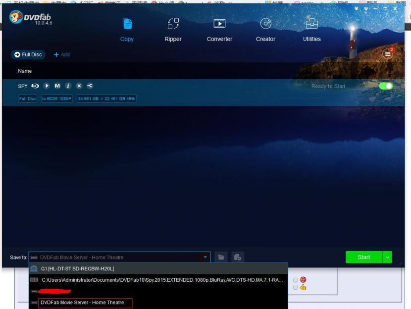

                        Before you copy, you choose save to your movie server. If your box is power on and pc is the same network, movie server can be list on your save to lists.
                        After copy work finish, fulldisc results can be copy to movie server.
                        You are usiong a wrong way to copy source.

                              Mine will not copy either
                              My PC and MS are on the same router. I see the MS through DVDFAB. I even changed the MS from Home Theater to Living Room and DVDFAB sees the new name. But when I try to perform a full disk copy it fails on step 3 of copying to the MS every time
