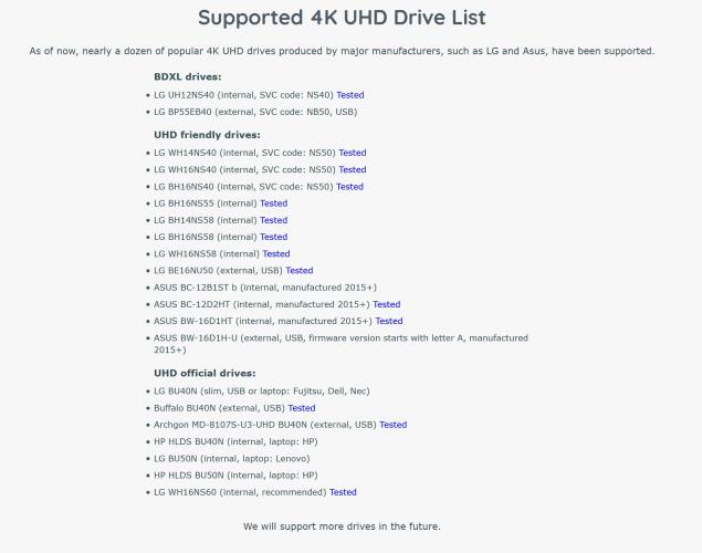

    Scroll down a bit on this page and you'll see all the UHD drives that are recommended/supported. You'll likely need to use DVDFab's "UHD Drive Tool" to downgrade the firmware once you make a purchase.
    Click image for larger version  Name:	Screenshot 2021-06-30 205548.jpg Views:	0 Size:	31.9 KB ID:	397031

      Thank you for the quick response.
      Eliminating the laptop and external drives leaves the LG WH16NS60.
      I'm in Australia and LG doesn't supply this locally so I'll have to look at international shipping, so I want to get the decision right before purchasing.
      For people who are using this drive, what are your experiences wirth DVDFab?
      The specs from LG specify an Intel chipset of SGX for UHD system requirements, there is a * indicating a footnote but I can't find that anywhere. My system is AMD rather than Intel and has the AMD X570 chipset, would this be an issue for UHD?
      Thanks again
        I am using the LG WH16NS60 with an AMD X570 board in an external USB enclosure and its been working fine. I haven't tested through SATA with X570 but it worked with my previous AMD board through SATA so either way is probably fine.
