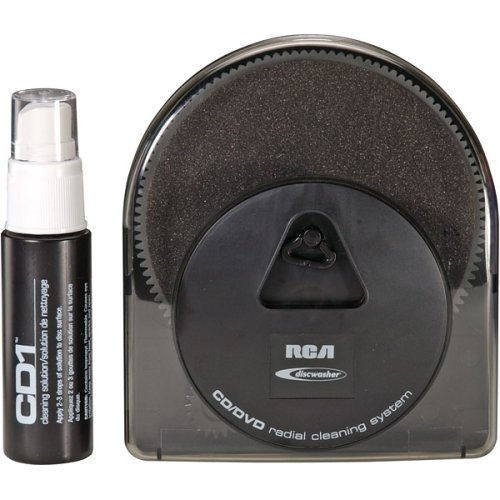

    I expect you will be hard pressed to find a WH16NS60 as I've read that LG has stopped production of those drives. I really like mine and I expect others who already have one will not part with theirs. Your WH16NS40 SVC code NS50 with fw 1.02 should work fine on 4K titles unless it is a title that DVDFab has not been updated to handle correctly. I have the No Time To Die 4K title and can test it with DVDFab if you like to make sure the program is happy with it. I've read that these 4K discs sometimes have residue on the data surface that prevents reliable playing or reading. Cleaning the disc has always resolved these issues for me using my trusty old Discwasher cleaning device & fluid.
