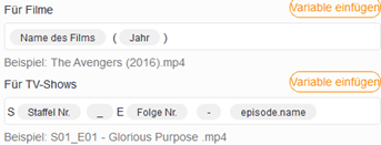

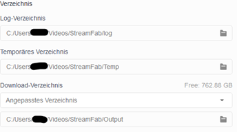

    Geänderte Einstellungen:
    Click image for larger version  Name:	grafik.png Views:	0 Size:	25.7 KB ID:	450709
    Click image for larger version  Name:	grafik.png Views:	0 Size:	25.8 KB ID:	450710
