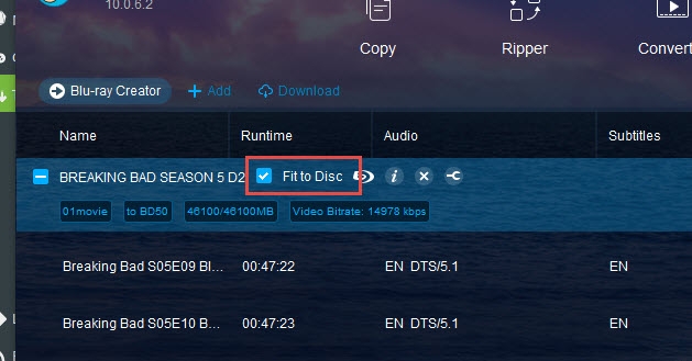

Greenie17 Hi. I am getting this error:Failed to burn due to oversized source filesTask_1 failed! Error=405Trying to put slightly over 46GB onto a 50GB blu-ray. I have fit to disc checked which drops my bitrate from 15000 to 14978.But it fails at the very end with the Error=405.Any ideas as how to fix that or what is causing it?Thanks.

Greenie17 Well they came out to be slightly over the Blue-ray disc. So I selected the FIT TO DISC selection like usual when it's lager then the destination disc and it usually works. Isn't dvdfab supposed to compress on the fly to make it fit? Am I missing something?No I didn't compress them myself nor did I use img burn to burn them. I have DVDFab burning engine selected. It's a 50GB blank disc which holds about 46.1GB.Thanks.

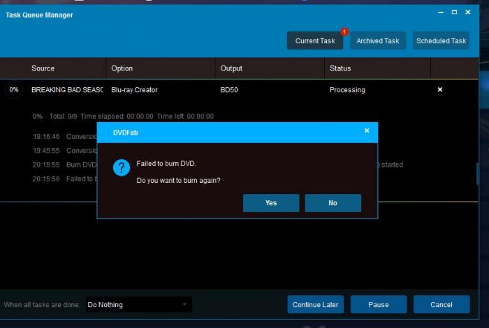

Greenie17 This is still failing even when I try to set to 4619889 or 47732. It does not ask me to fit to disc but I still get the error attached.
