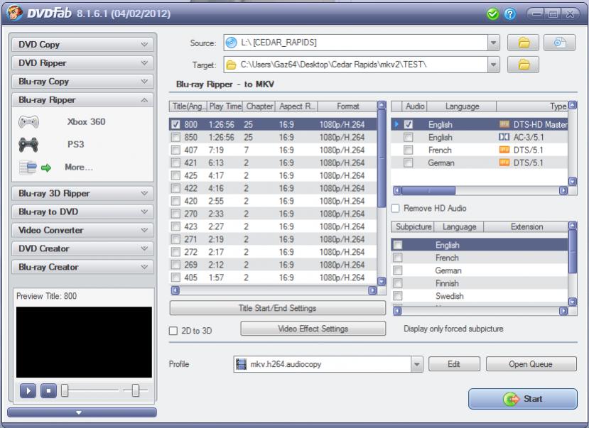

                  It's BLUE RAY RIPPER > MORE > MKV then at the profile window use drop down arrow and select > MKV audio copy
                  After that I pretty well go with the default settings although I have GPU acceleration turned off and also lightning encode.
                  Ripping time is approx 1hr 20min on a I5 750 with 12gig ram running Win 7 Pro 64bit. Results are excellent. I save to NAS and view via networked WDTV media player (no DTS master audio unfortunately but plays the core no problems) See attached

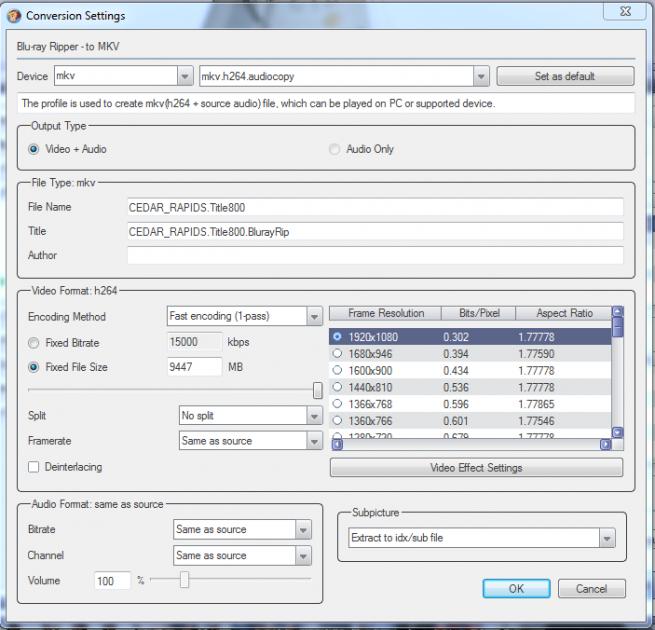

                      You really have me confused here. I just ran through the settings on an MKV rip I have been playing with last night and it beats me how you get a 25GIG outcome. The only way I know to alter the size is by choosing >FIXED FILE size in the Edit window and pulling the slider to the right. When I do this I the maximum file size comes up as 9.4 GIG (see attached PNG4)
