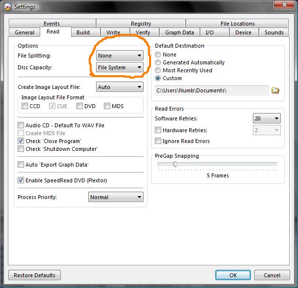

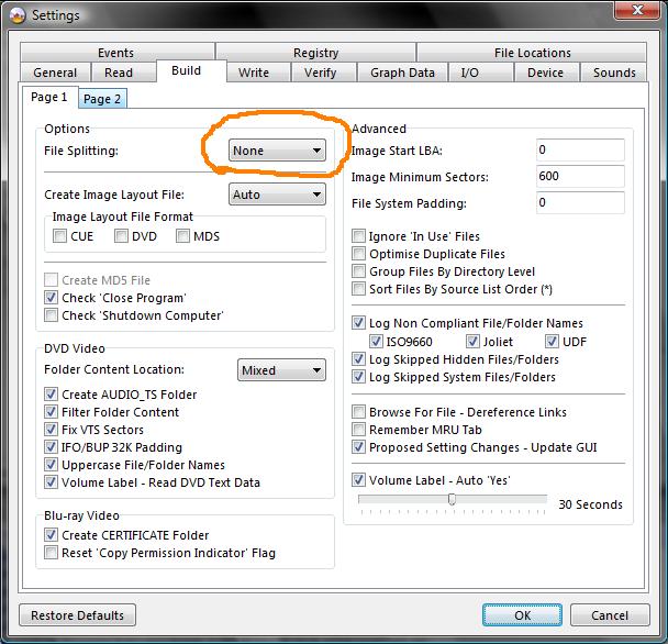

        correct BD50 was the output I selected also, I think I know what it is. You're using the included VSO burn engine within Fab? d/l IMGBurn and please follow Troy512's video on how to set it up to work with Fab and then I have just a couple other settings to change within IMGBurn also.

            cool, post back with results and if still no joy I'll go through every setting I have within imgburn with you because I promise I am ending up with 1 .mt2s file lol

                    Edit: these are my personal settings for ImgBurn but still not sure if ripping Blu-ray to HDD other than ISO as the target has anything to do with ImgBurn. like I said stumped here
