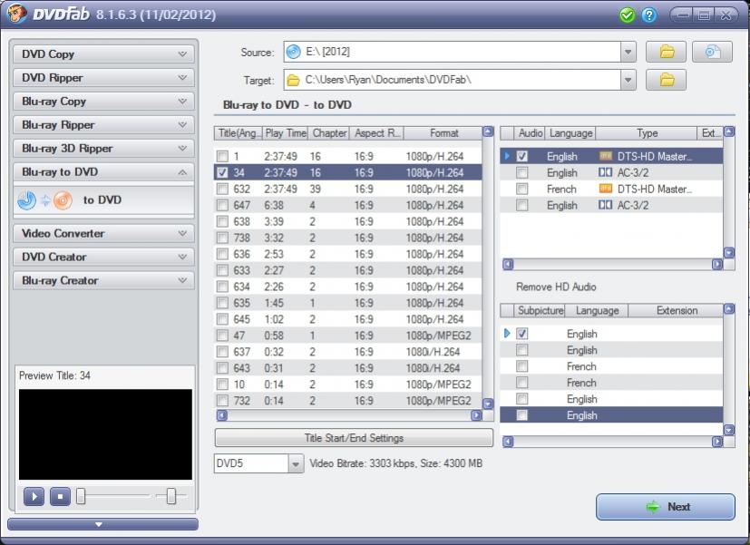

    I am having a problem with this movie and it is extremely frustrating. I just bought the Bluray but I cannot get the forced subtitles to work (I only want subtitles for the foreign language parts of the movie). The movie has 3 video streams that are all 2:37:49, the first stream has 3 english subtitles, the second has 4, and the third only has 1. I have tried the force subtitles on all of them but it is not working. The subtitles are either always on, or always off. I would like someone to help me out if they can.

    This movie has 88 subtitles that are forced, translating Russian, French and Chinese to English. In the DVD, all the forced subs are in the same stream as the main English subs (the top one in the list) and I think the BD is the same. The problem seems to be that you have the default arrow (the small blue triangle next to the selection box) turned on in all the screen captures you attached, which will cause the entire stream to be displayed at all times. Select only the top English stream by putting a check in its box and turn the default arrow off by clicking on it.

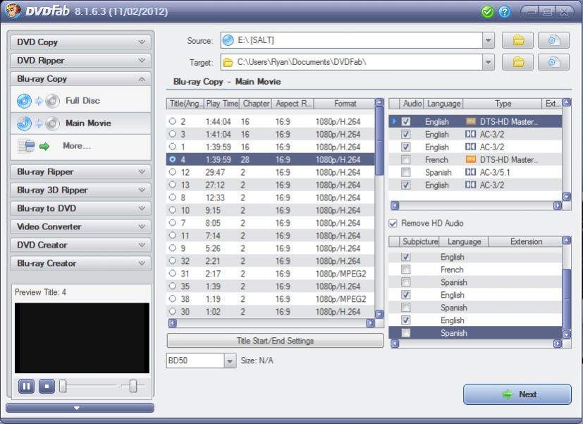

    To make sure you have the correct title selected, switch to Blu-ray Copy mode and see which one DVDFab selects as the Main Movie. You are using Blu-ray to DVD but posted in the Ripper forum, so I will move your thread to the correct place.
      Thank you for your suggestions, unfortunately they did not work. I started DVDfab and selected Bluray copy. After I put the disk in and it was scanned DVDfab selected track #4 and preselected all the english audio tracks and english subtitles. At first I played it using the preview window and I was unable to get subtitles to show up unless I put the blue triangle next to one, but since you said I should not do that I didn't. Instead I just switched to Bluray to dvd and clicked next. The end result was a movie that did not automatically play any subtitles.
