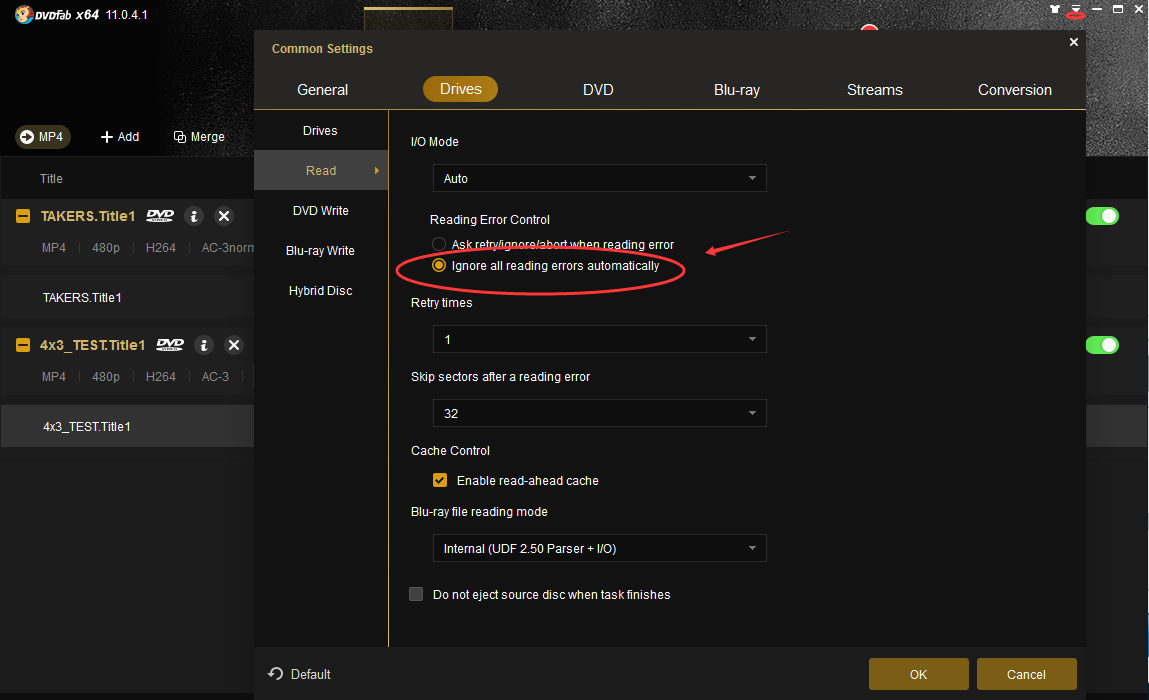

          Hi, please set it to ignore all read error in DVDFab Common Settings window to try again.
          Also, if you still have the original movie disc, please give it a try.
            I don't see that option anywhere. Please specify the correct menu path to that setting - thanks.
              Please check image attached.
