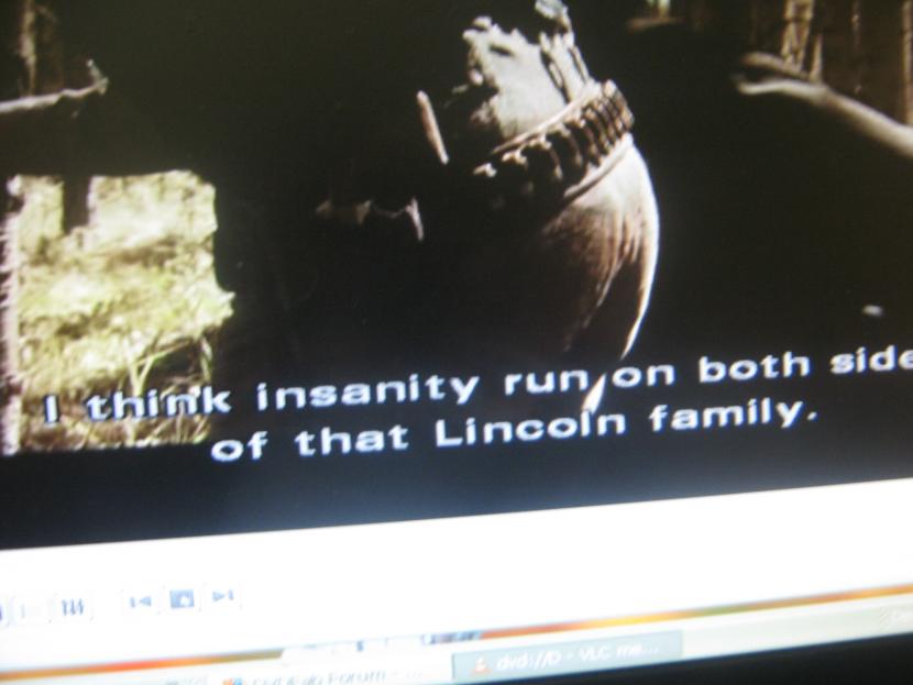

                  Well, i worked it out. I played the DVD on VLC Media Player and the subtitles worked great, so it appears Windows Media Player is not the one to do it unless you know something else. Thank You.

                    Another thing i noticed, i get subtitles when theyr`e speaking english as well as other. Any ideas?
                      There is a difference in player response between "default subs" (which is what you are making) and "forced subs", which are normally used for translations. All subs in the stream will play whether they are forced subs or not if you make them "default" by processing them the way that you have. It is normal. The "forced" subs will play (on most players) without turning on the default arrow in DVDFab. Why are you re-processing the disc with DVDShrink?
