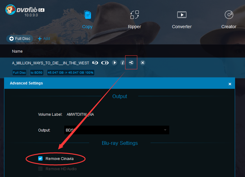

      Copy-full disc mode supports to remove Cinavia. You can set it to remove Cinavia in the advanced settings window, and the result file shall not contain Cinavia. Click image for larger version  Name:	remove Cinavia.png Views:	1 Size:	159.3 KB ID:	353846

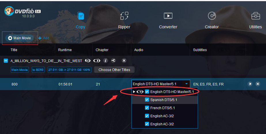

      You can also use Main Movie mode to remove Cinavia directly. Click image for larger version  Name:	remove Cinavia in main movie.png Views:	1 Size:	258.0 KB ID:	353847
