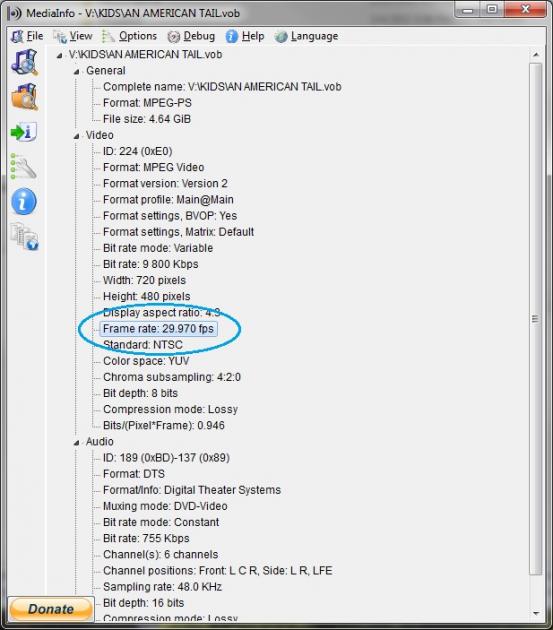

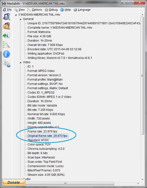

[QUOTE=CBR929;88757]Hi tjkaz
I have just run a test using a 29.970 frame rate video that I have and you are correct, the A/V sync is way off.
Can you use a different profile?
I also ran another test using the generic.mkv.h264.audiocopy and having 23.976 as the frame rate and the A/V sync was dead on perfect.
Maybe the developer will see this and get this fixed.
CBR929[/QUOTE]
Thanks CBR929. The closest thing for me to use would be VOB passthrough. I do not want to decode/encode, compress, etc. I was hoping that this would get fixed in subsequent releases, but for some reason it has not been. I just tried 8.1.0.3 Qt and same result. I've tried ripping to HD first, software only (which shouldn't matter for remux), pathplayer enabled, disabled, only when needed, etc. and nothing seems to make a difference.
I used to be able to fix afterwards with MKVmerge, but for some reason, I'm only able to fix about half of them.
Fentao, Ting, other Devs: is this issue on the "fix-it" list??
