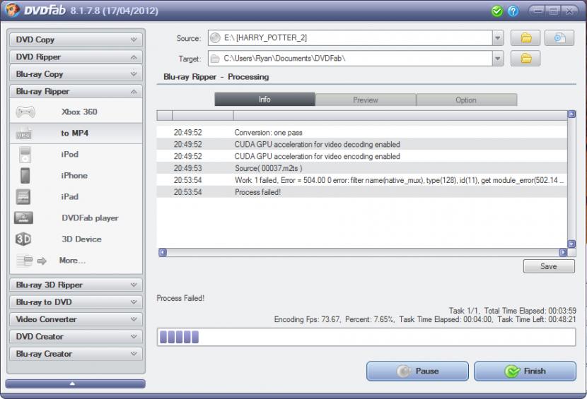

    I am trying to rip Harry potter with the mp4.h264.aac profile and I have the bitrate set at 11000. However the rip only gets part way through before it fails.
    I have attached a screenshot of the error, and the logs. If you have any suggestions I would appreciate it.
    Hi ryanmc
    Open Fab click the Click the Green at top right corner of the DVD Fab screen, and open Common Settings > General >A/V Codec, put a check in Disable all GPU codes and make sure they are set to Software, restart Fab and try again.

      Thanks, that works, but it is now taking about 2 hours to rip each movie. Is this a problem with these specific disks, or is there something else going on? It would be nice if I could use hardware encoding to speed things up.
