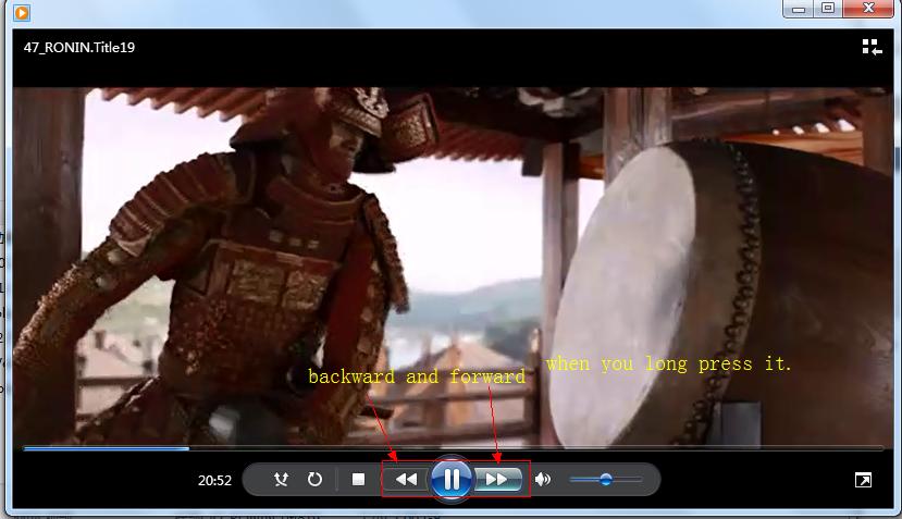

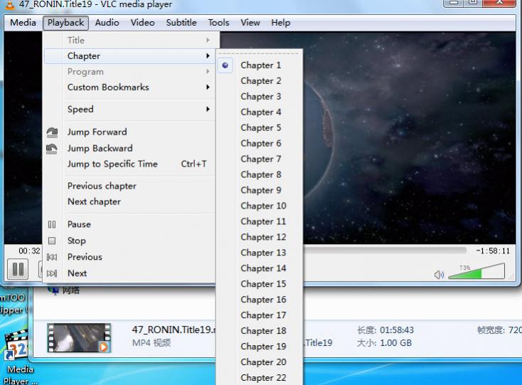

          Hi ahelwig
          I have ripped a dvd to Play Station 3(MP4), the results has chapter when play in vlc and player 2.
          Like GregiBoy said a lot of MP4 players do not support chapter marks.
          I also play it through windows media player. It has no next chapter button.
          I do not know if we use the same version windows media player. See my picture play on VLC and my windows media player.
