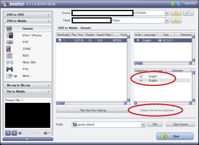

              Here is the example with screen captures for syriana: (GregiBoy is this the same type of problem you are having?)
              I can get forced sub titles only using the PS3 profile but not the Generic AVI

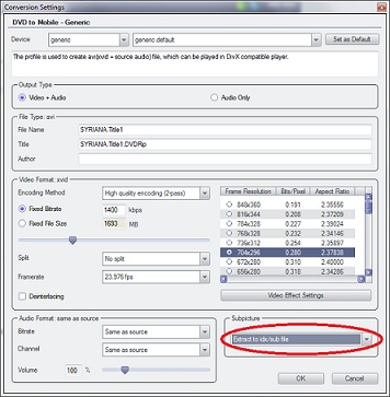

              Generic Profile ---------------------------------
              1) Notice in the sryiana_generic.jpg screen capture both subtitles can be selected at once. But the "display only forced sub picture" is disabled.

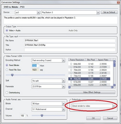

              2) Notice in the syrana_generic_render.jpg screen caputure I cannot select render to screen.

              3) Notice in the syriana_PS3.jpg screen capture I can only select one or the other but it won't let both of them be selected at once. Also the "display only forced sub picture" is available to be checked.
              4) Notice in the syriana_ps3_render.jpg screen capture I can select render to screen.
