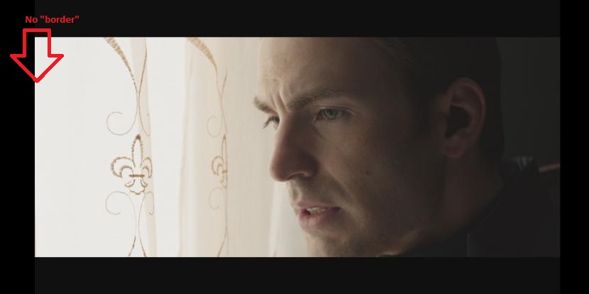

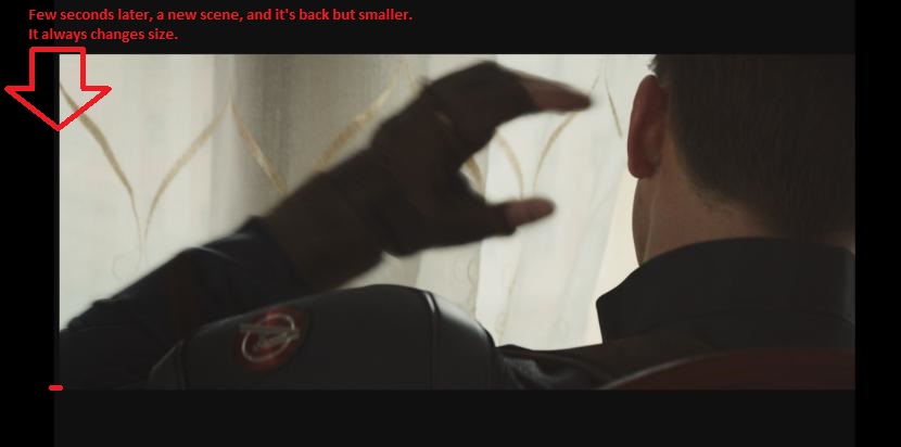

    The left eye on most 3d movies seems to have a black border on the left hand side for some scenes, but the center point that splits the left and right eye is static, with the right eye always the same width. It seems to be only the left eye width that keeps changing.
    I will say occasionally it doesn't happen (or is so infrequent it's not noticed), but on most movies it does happen, but still infrequently. However it's unmissable for Captain America: Civil War, it's all over the place.

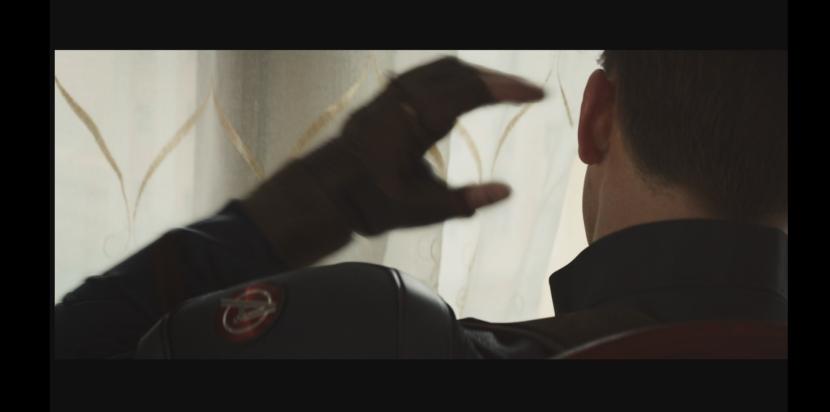

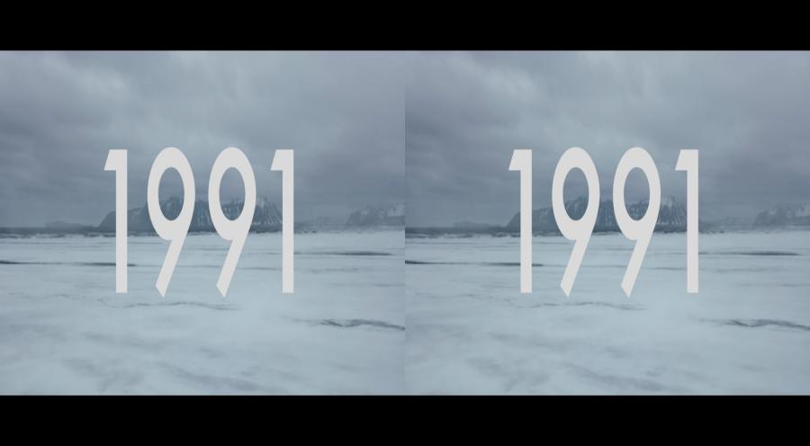

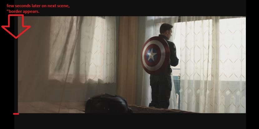

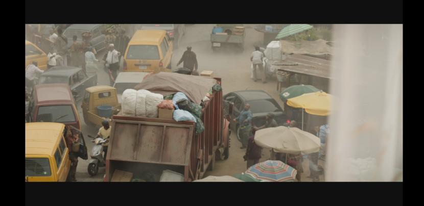

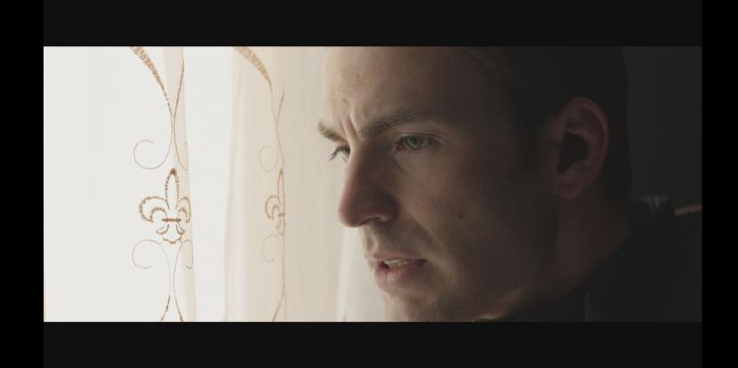

    Have a look a the attachments. This scene was just a random pick, with the images being around 5-10 seconds apart. I've taken the images as a 2 copy to show off the issue more as the frame is bigger. The whole movie is like this.

          Screenshot 1 shows movie as side by side 3d before the tv put them together not at full screen so you see borders left and right sides.The top and bottom is black boarders because picture is also letterboxed. Fabs default setting takes the black bars out before encoding the movie anyway the black bars above and below the picture are not encoded into the movie to do so would waste room so Fab will auto crop them out anyway what you see are still black space but not encoded into the film.
          Screenshot two also shows the side by side pictures before the tv turns them into 1 3d picture but this is at (full screen) the regular 3d setting to watch any movie 3d or not to fill the screen with whats on the film not enlarging in any way it's just that your computer as part of windows shows large and smaller sizes when showing any video 3d or not.
          Here you see no boarders on the left and right side just the top and bottom where Fab removed the letterboxed bars to save space and to encode/decode just the picture info. the black bars are whats left on the top and bottom their not in the picture anymore even though they appear as black bars above and below the picture.

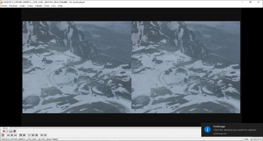

            • The large borders on the left and right, were because it was being played in VLC from a 2d rip, 1 for ease of getting a screenshot, and 2 to make the image larger so the border was more visible as opposed to uploading 3 SBS images. There actually isn't any borders, If you look at the top an bottom of the images you can see where the actual image start/stops (as it's more grey than black).
            Actually, the more I'm reading, and specifically when I get to your second post. It seems that your talking about the borders in general...I talking about the left eye image within the border with the 960x960 horizontal. I've re-uploaded the images with pointers...
