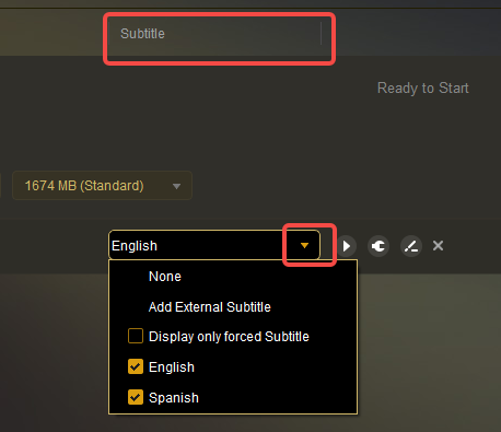

    Do you get any subtitle streams here and have you picked one?
    From the log file, it seems that you haven't selected any subtitles before the conversion started.

              Click image for larger version  Name:	screenshot-20211223-122833.png Views:	45 Size:	20.8 KB ID:	404377

              In my previous post, I asked whether you have any subtitle streams under the subtitle list, and you said you "have tried them all!" I should have asked for more info.
              --So you get subtitle options shown in the list, but no matter which you picked, there was no subtitle in the output file?
              Please kindly display the list take a screenshot of that and show us, thank you.
