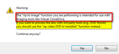

              Maybe it does as I would not know because I only use it about every 2 or 3 months. The Big warning you get before you rip to hard drive as ISO! See attachment. If you are only going to view on computer using virtual drive then using rip to iso can be used see attachment red box. If you are going to process with a DVD Copy program then you need to use rip dvd video to hard disk see highlight
                Gotcha. I'm no newbie where ripping DVDs is concerned, the copy protection has been removed. The problem is the 2-pass encoding. I hope you guys can fix it in the next release.
