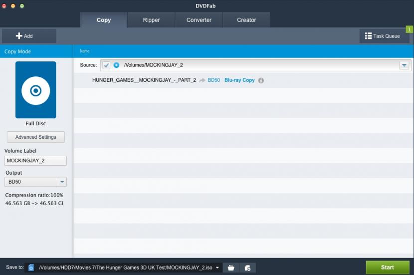

    Did a complete fresh, wipe out all preferences/kexts etc (log included) and tried to do a Full Disc rip to ISO. ISO seems to play fine on KDLink720 as ISO.
    Problem is Oppo BDP-93's won't play ISO. Simple solution; mount ISO and put the three folders into a named folder on external eSATA/USB drive, and although twice the size, plays like a charm. 3D. Dolby Atmos or whatever HD format the original is. Works great. Do it all the time. Usually.

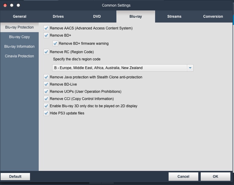

    With this disc I set the Region to B/2, I have Cinavia unchecked as none of my machine are infected with it (tried it with it on, too), rip a nice ISO, mount and then move the 100gbs to the external and hit play on the Oppo.

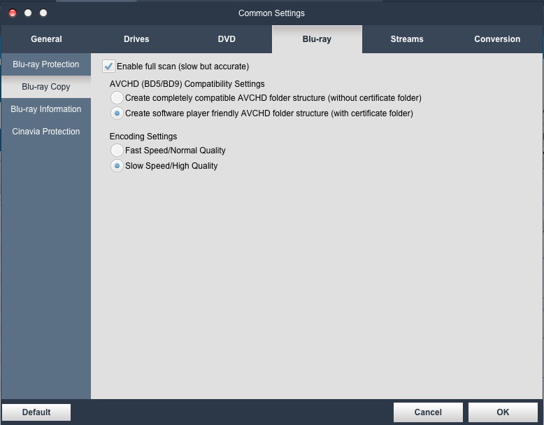

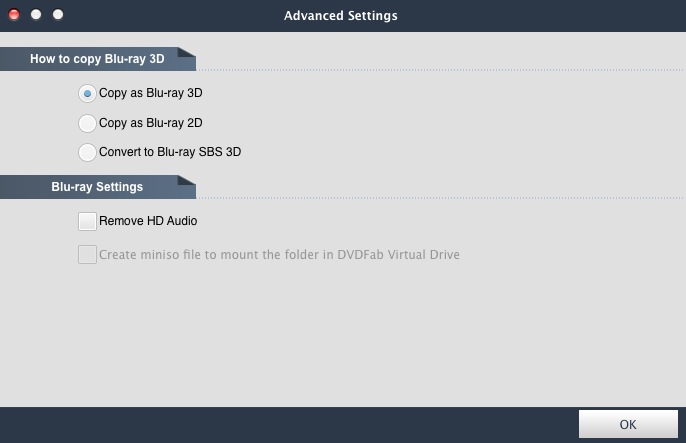

    I've attached setting screen shots and internal log
