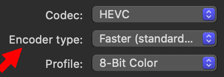

NOTE: HDR media requires using a 10-bit codec, which is why compressing 10-bit HEVC quickly is important.
To enable hardware acceleration, be sure to select Faster for the Encoding type in the Video Inspector. Setting the Encoder type to Slower performs compression using software, which is much, much, much slower.

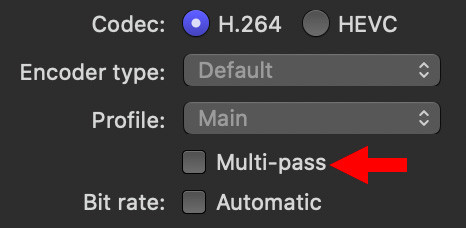

NOTE: On another note, Multi-pass also switches to software-based encoding. In the past, we would do this to improve image quality. Given the speed and quality of today’s hardware-accelerated compression, there are very few reasons to use the Multi-pass option today.
