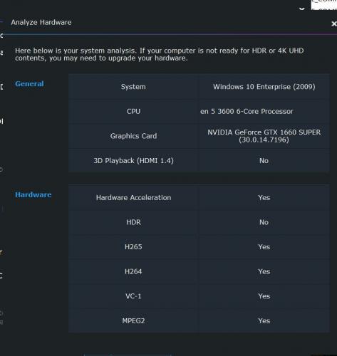

                I'm having the same issue with Fraggle Rock (Blu-ray) (UPC 043396540132). Player 6.1.1.7 (and previous versions) crashes out most of the time. Some times it does bring up the menu. Mouse doesn't work at all on menus. Keyboard works if the menu pulls up. Zip file errors out when trying to attach to this thread. If you have another way I can send it in let me know. Hardware Analysis attached.

                  Some menu only supports control by Keyboard. Do you have the crash issue with other Blu-rays? Please list them too.

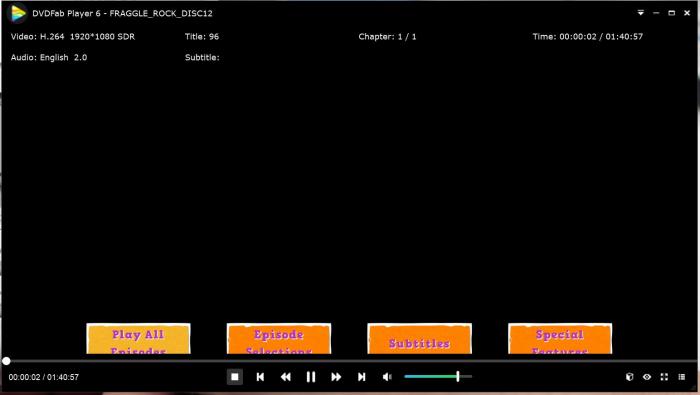

                      Here's a picture of the application when it hangs/crashes on menu load. Time count just stops at 00:00:02, no artwork loads, partial menus load (but don't do anything), not responsive to keyboard or mouse interaction.
                      and Windows Event Viewer data:
                      The program DVDFab Player 6.exe version 6.1.1.7 stopped interacting with Windows and was closed. To see if more information about the problem is available, check the problem history in the Security and Maintenance control panel.
                      Process ID: 237f0
                      Start Time: 01d7cf50dfaddc45
                      Termination Time: 11
                      Application Path: C:\Program Files (x86)\DVDFab\Player 6\DVDFab Player 6.exe
                      Report Id: 49c02c5b-a4cb-4cd6-90ff-928d70b2dc1d
                      Faulting package full name:
                      Faulting package-relative application ID:
                      Hang type: Unknown

                        I've checked with the developer who confirmed that there is some playback issue for some movies while using Menu mode, they will need time to check it out. He suggested that you use the simple mode to playback the problematic discs for now. Sorry for any inconvenience in this case.
                          The problem with that suggestion is with TV series, there's at least 8 episodes per disc. In this particular case there's variations of the 8 episodes (sing-a-longs, etc) and I need DVDFab Player Menu Mode to tell me which episode correlates to which Title on the disc for ripping; Simple Mode won't do this. For now I've had enough successful menu loads that I'm able to work, but this is a problem that needs fixing.

                            I have passed your update to the developer.
