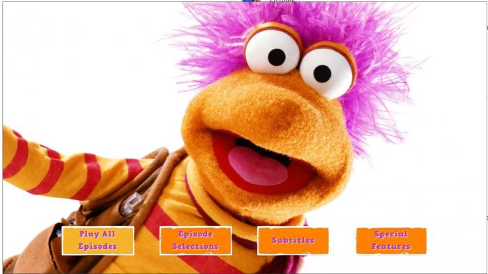

    Here's a picture of the application when it hangs/crashes on menu load. Time count just stops at 00:00:02, no artwork loads, partial menus load (but don't do anything), not responsive to keyboard or mouse interaction.
    Click image for larger version  Name:	Capture.JPG Views:	3 Size:	20.6 KB ID:	401868
    and Windows Event Viewer data:
    The program DVDFab Player 6.exe version 6.1.1.7 stopped interacting with Windows and was closed. To see if more information about the problem is available, check the problem history in the Security and Maintenance control panel.
    Process ID: 237f0
    Start Time: 01d7cf50dfaddc45
    Termination Time: 11
    Application Path: C:\Program Files (x86)\DVDFab\Player 6\DVDFab Player 6.exe
    Report Id: 49c02c5b-a4cb-4cd6-90ff-928d70b2dc1d
    Faulting package full name:
    Faulting package-relative application ID:
    Hang type: Unknown
    Leave a comment:

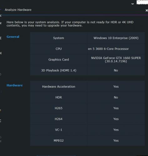

    I'm having the same issue with Fraggle Rock (Blu-ray) (UPC 043396540132). Player 6.1.1.7 (and previous versions) crashes out most of the time. Some times it does bring up the menu. Mouse doesn't work at all on menus. Keyboard works if the menu pulls up. Zip file errors out when trying to attach to this thread. If you have another way I can send it in let me know. Hardware Analysis attached.
    Some menu only supports control by Keyboard. Do you have the crash issue with other Blu-rays? Please list them too.
    Leave a comment:
