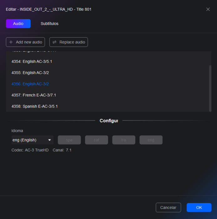

    I want to inform you that yesterday I tried to replace audio and subtitles on a multi-angle UHD, and the process did not work correctly.
    UHD INSIDE OUT 2, replacing Spanish Latin EAC3 7.1 material with Castilian DTS 5.1 Blu-ray from Spain.
    IMAGE ONE

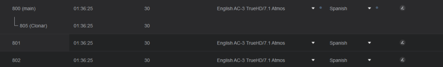

    When preselecting the mpls to replace, there was one that indicated 800 (main) and 805 (Clone).
    There are also two more in a row 801 and 802, which I understand that the previous option means that from 800 to 805 it clones.

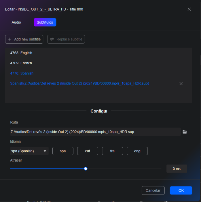

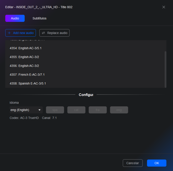

    IMAGES TWO AND THREE
    Once the changes have been made in both audio and subtitles, the process is executed.

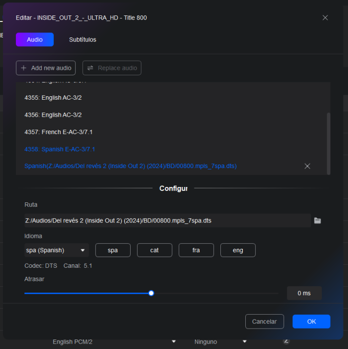

    IMAGE FOUR
    Result of the process in mpls 800 and 805, they are correct as you will see, DTS 5.1 is applied.

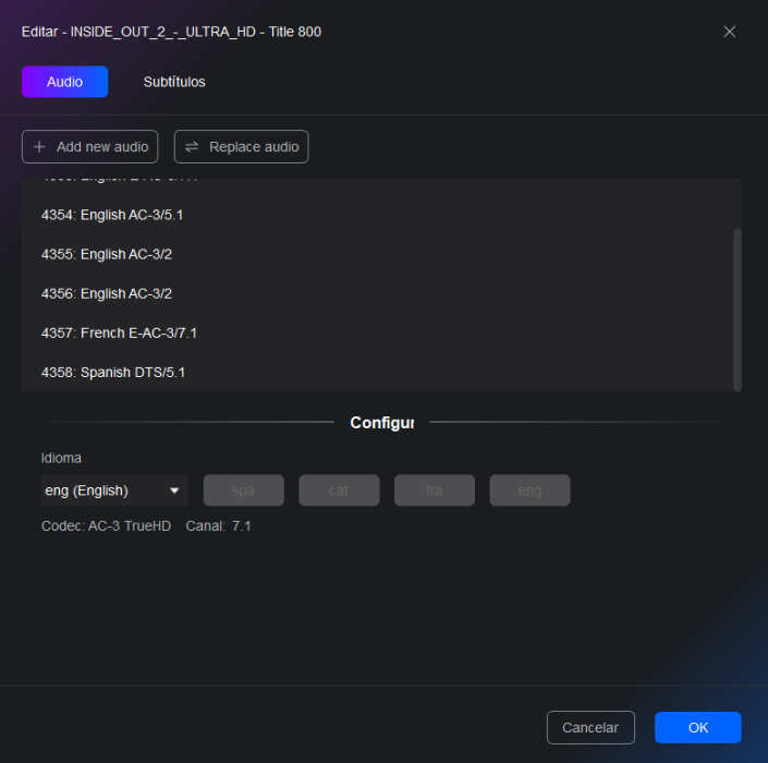

    IMAGES FIVE AND SIX
    Result of the process in mpls 801 and 802, they are not correct as you can see, EAC3 5.1 applies.
    The result of which is that the playback of the resulting file does not work with the replaced audio.
    I also tried to make the changes in mpls 800 and 805, 801, 802, but it did not work either, since it duplicates the audios keeping EAC3 7.1 as the main one and DTS 5.1 as inactive.
