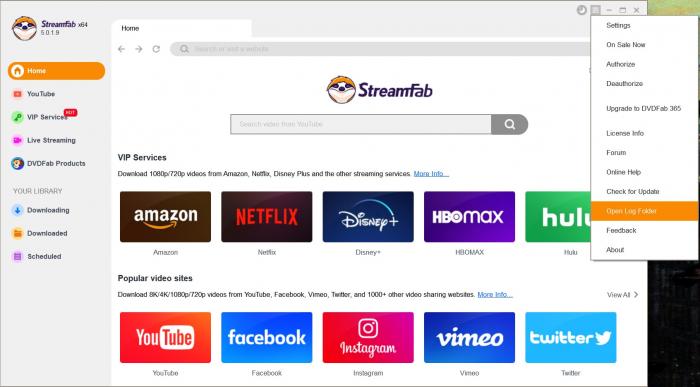

    1. Open Streamfab, chose three bars at top right (settings) & then "Open Log Folder"
    2. This shows me the logical path of "This PC > Documents > DVDFab > StreamFab > Log" where the log files are stored.
    To see the physical path (C:\etc...) click the folder Icon to the left of the Logical path and I see,
    C:\users\XXX\Documents\DVDFab\StreamFab\Log, where XXX is the user name logon.
    3. You can copy log files from here to attach to posts for StreamFab Technical analysis.

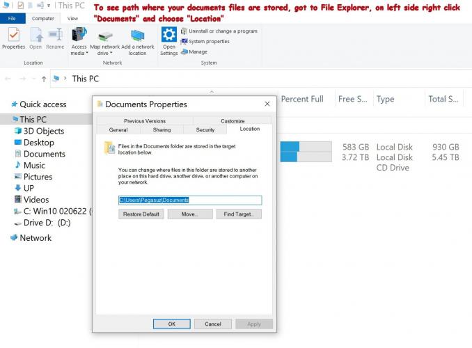

    2. I discovered my documents path was not the standard defined path above, when I had to go troubleshoot a problem.
    From some action in the past, the path was redefined without my concious knowledge.
    I reset the storage of my document folders to default (see attached 4th file) by going to "File Explorer", right clicking with "Documents" on the left side of screen, choosing "Properties", choosing "Location" and clicking "Restore Default".
    It redefined the path for my PC Documents folder and copied all the folders and files that were in the old path.
