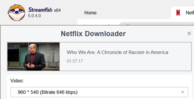

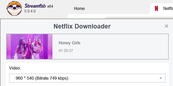

I am using Edge and it gives you the same 540p in a regular browser, without using StreamFab, checked with poster 'Mike_M'.... first post here: (It's the same crap)

Here's what I think is happening.
Netflix is serving those files at the lower resolution of 960x540 (New Sony Films) and you can't override the playback of them via the addon's for Chrome and Firefox, but you can play them at higher resolutions in
NetFlix App or Edge.I believe this lock to lower resolutions in Chrome/Firefox and allowing higher in NetFlix App and Edge is due to later using Windows DRM and not allowing screen capturing.

I have no idea how downloaders (StreamFab & another) will get around this serving of these files at that resolution since Netflix is sensing the interfacing environment and I think using adaptive streaming and only serves higher when resolutions when utilized with Windows DRM programs such as Netflix App and Edge.
I really hope this 960x540 doesn't proliferate.
