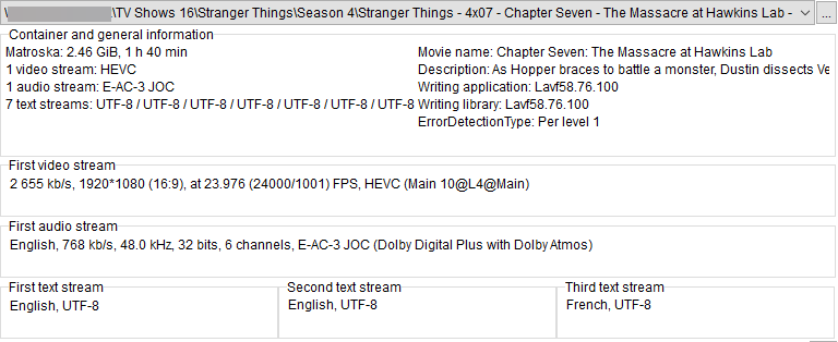

    So, a very popular series (Stranger Things 4) reports that it has Atmos as an option when opened with SF. Yes, it is by episode, no analyzing the entire series thing, in this case, episode 7. When I play it back though I get lossy stereo 128 audio. Media info also reports the mkv to have 128 stereo. Where did the Atmos go? Forcing it to download eac multichannel instead, it still downloads stereo 128.
    [Just tried it with a different stream, still stuck at stereo audio]

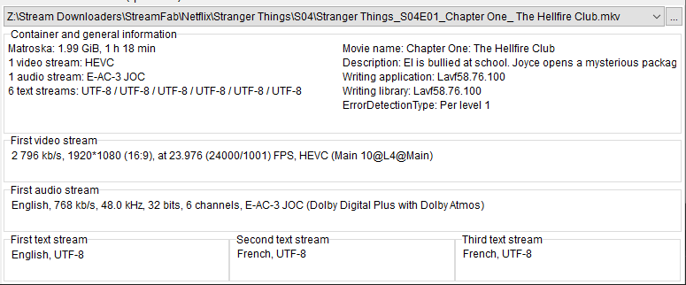

          I downloaded it with Atmos, with an earlier version of StreamFab before you unlocked H265.
          I just tried now with v6.1.1.4 and i get the Atmos only if i have it analyze Season 4, which is expected behaviour.

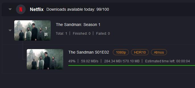

              [Edit] Just tried The Sandman, let it in default audio (which says Atmos) and it worked.
              If I manually change it to Multichannel eac3 instead, it downloads Stereo audio only again.

                  Yes i got 768:

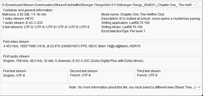

                  For Stranger Things, do this:
                  • Click the inverted caret to start the analysis.
                  • Click cancel on the pop-up
                  • Use the drop-down to select Stranger Things 4
                  • Click on any episode of Season 4 to restart the analysis
                  • Now select Atmos and download the episodes
                  If you see that StreamFab doesn't automatically select a Season 4 episode, it won't work.
                  You will need to go to Netflix on your regular browser and play an episode from Season 4 for like 5-10 seconds then stop it and go back to SF and click the show.
                  It should now pre-select that episode you played and will download the Atmos if you select that audio.

                    I just downloaded 2 episodes of The Sandman, go the 768 multichannel "Atmos" audio. Got the third episode, although it is selected "Atmos" it went back to stereo again on the final file. How many times must I delete the log files folder? This absolutely is a new issue.
