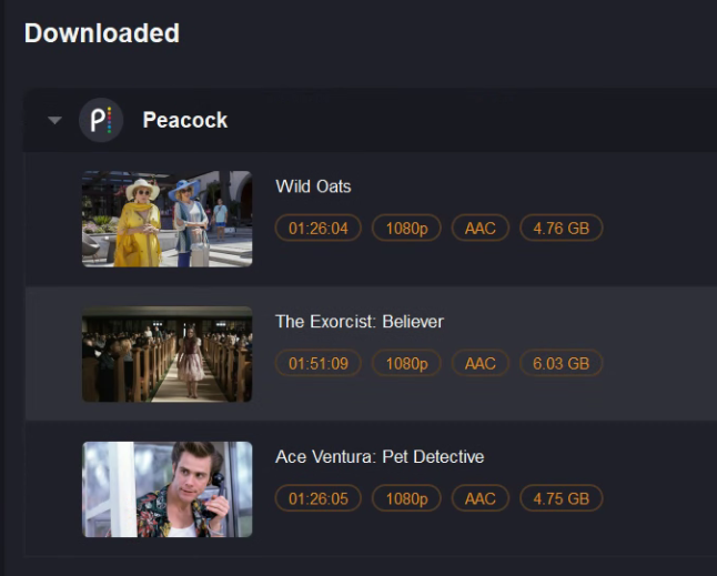

      I just downloaded 3 randomly chosen movies from Peacock without any problem.
Name:	Screenshot 2023-12-08 5.53.06 AM.png

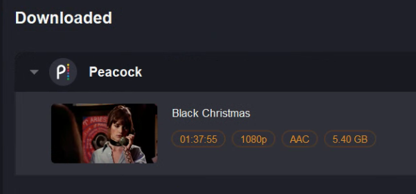

                I downloaded with no problem.
                Click image for larger version  Name:	Screenshot 2023-12-10 10.21.14 PM.png Views:	0 Size:	69.1 KB ID:	434004
                I looked at your StreamFab.log and found it very interesting. It appears to me that the reason for the failure to analyze is because Peacock is giving you a "OVP_00311" error. That error shows up if you have too many devices active at the same time. You are allowed 3 devices connected and active to Peacock at a time. Were you running more than that when you tried to download Black Christmas? I've also seen Peacock be very finicky when you have too many devices listed total, active or not. My suggestion to clear that up is to go into your Peacock account and click on Devices and close all but the latest StreamFab listing. Unfortunately, unlike other streamers, Peacock will let you keep the active device that you are logged in on but all others must be deleted at the same time. That means that you may have to re-setup your TV or other devices. Try that and let me know how it goes. Please send the new StreamFab.log.

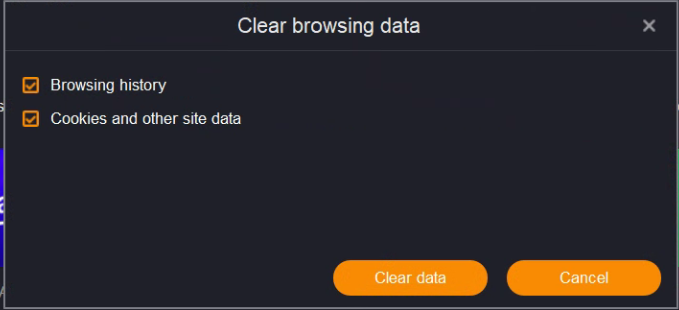

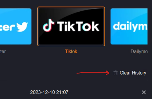

                And back to the "OVP_00311" error, Peacock recommends, along with other things that don't pertain, to:
                • Clear your device'™s cache and data. You should be able to clear cache/data in your device's settings menu.
                Besides that, it never hurts to clear your history, cookies and other data after every session.
                Click image for larger version  Name:	Screenshot 2023-12-10 10.26.57 PM.png Views:	0 Size:	61.5 KB ID:	434005
                Click image for larger version  Name:	Screenshot 2023-12-10 10.30.00 PM.png Views:	0 Size:	53.5 KB ID:	434006
