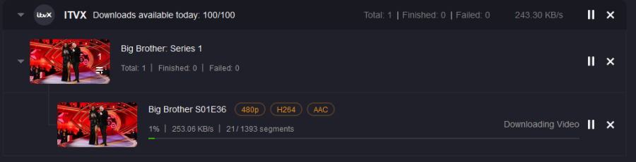

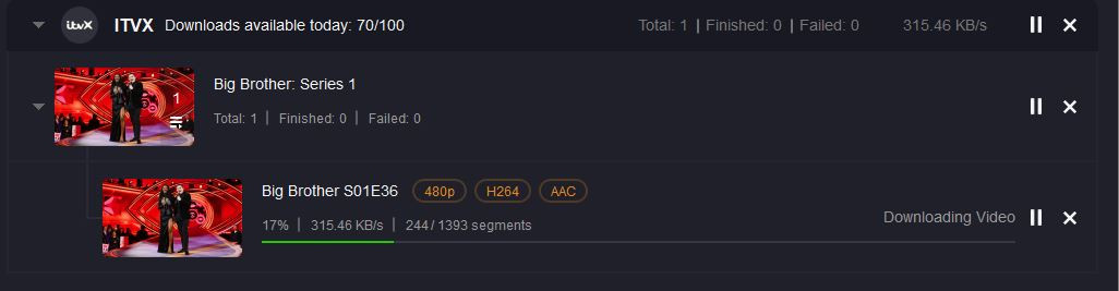

                Still 480p for Big Brother. I don't have Premium. Attached log file and screenshot showing 480p.
                  Not sure if the log attached on last post.
                    I'm not seeing anything unusual in your log this time until the Remux. Everything looks normal to me until after the Remux and then it shows 480p. Your screenshot says otherwise though with the 480p showing in the download. Confusing. I guess I'm going to have to load up 6.1.5.4 and use up one of my ITVX trials.

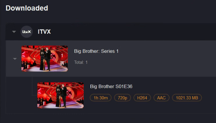

                        I just used up one free ITVX trial and had no problem getting Big Brother S01E36 at 720p. I say no problem but I thought the video part of the download was way slower than it should be, but that has nothing to do with your problem. It might have been a VPN issue, hopefully.

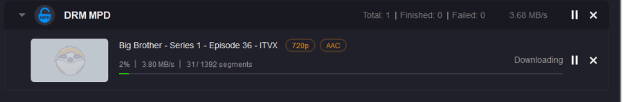

                            Uninstalled all versions. Still 480p. Reinstalled 6.1.5.3 and got 720p using DRM (also faster download speed). Not sure what Chameleon means by keys. I purchased the ITV downloader which offers 720p - and the video is clearly available in 720p. Thanks to all for the help so far.

                              Sorry, you've lost me (as well as plybyplyax) on this. I was able to download at 720p using one of my free trials and so was he on another machine. So, StreamFab obviously does have the keys. I asked him to try a clean install of StreamFab on the computer that was only getting 480p thinking something was not right initially with the installation of SF on that machine. Being that nothing changed for him using 6.1.5.4 left me confused. When he went back to 6.1.5.3 using MPD and was able to download at 720p and at a faster speed, this matched my results for that Big Brother episode. I realize now that the reason my MPD download failed during Processing the first time was that I never was asked nor did I give my username/password. Correcting that makes it work fine and fast. I'm starting to think there is something not totally correct yet about this new ITVX module. Using the previous itv.com MPD method is much better. The new module only works in M3U8 and is terribly slow.
