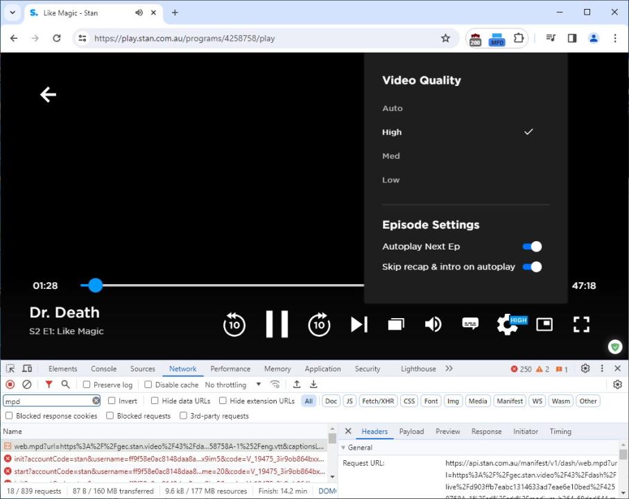

    Only 540p can be played in the Windows browser - so SF can't download better.
    Tested with Chrome + Edge, there is only "High" with 540p:
    (api shows 234p, 360p, 540p, 1080p, 2160p - no 720p)​

    Earlier i could change mpd url /sd/ to /hd/ - but it doesn't work anymore.
    Stan offer HD + 4k UHD apparently only for TVs - listed "Supported Devices" here
      Which Stan subscription plan do you have?
        The Premium one with the 4k option.
                You nailed it again, Germania. I knew the Basic level was SD only, but he had Premium. I never thought that they would limit a Premium subscriber to SD on a browser. But it is all there in black and white in "Supported Devices". The worst thing is that they don't just come out and say that if you're using a browser, you're out of luck. They take the easy way out and just point you to the devices and hide it by omission.
