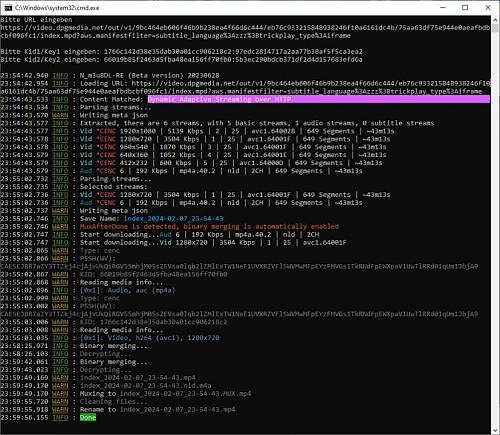

    I've tested only a free VTMgo title: Milo S1 A1
    SF can't play: Er ging iets mis, probeer het later opnieuw
    In Log I see only 509 (509 = Bandwidth Limit Exceeded ?)
    So I tried manually and received 7 Keys (3rd vid, 5th aud)
    License server is like: 6play.fr, molotov.tv, cmore, mubi

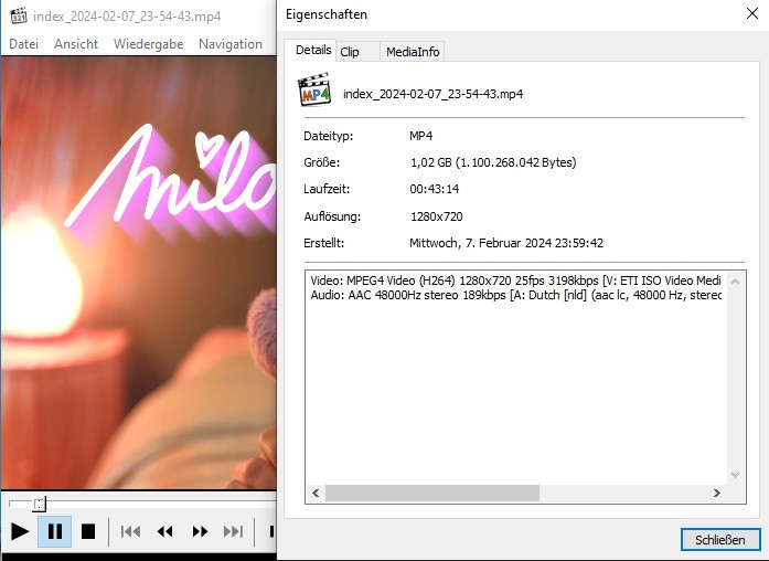

    Result
