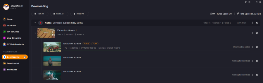

                      Not wishing to complicate matters (only offering this as a help), but I've just downloaded (without any issues) 4 episodes of a Netflix series in 1080p!
                      Click image for larger version  Name:	Screenshot (1340).png Views:	0 Size:	60.0 KB ID:	438343
                      I'm based in the UK.
                      Not knowing the titles being affected, as weavermovies clearly stated: "..there can still be certain titles that will cause problems.."
                      Toonces T. Cat please give the titles you are struggling to download and we can test them.
