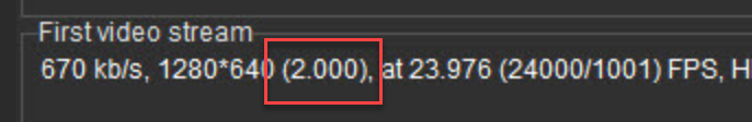

MAX video is not 720p its 640p and thats not HD
    Max MAX video is not 720p its 640p and thats not HD
    If anyone is interested, check out MediaInfo when you download a MAX video. It's not 720pHD; it's 640p SD.

        Click image for larger version  Name:	640k.jpg Views:	0 Size:	169.6 KB ID:	445746

              Your MediaInfo shot is even telling you its a 2.0:1 aspect ratio as Max hasn't included the black bars in the image to pad it out to 1280x720.
              Click image for larger version  Name:	image.png Views:	0 Size:	63.5 KB ID:	445775
              1280 x 640 is 720p at 2.0:1 aspect ratio (no black bars included to make it 16x9). It is not 640p.
