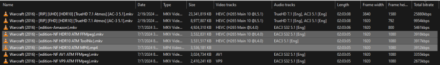

    HDR10 content downloaded from Netflix does not play back smoothly on my local hard wired devices streaming from my Plex server, so I'm investigating. This is not a new issue - has been ongoing for years.
    Used Warcraft as an example since I own the UHD disk to rip and can currently download it on multiple services.
    Of all of these files, only the highlighted ones have issues.
    - Since it doesn't show up, MediaInfo for the MP4 version says Main 10@L4@Main.

    Just some notes:
    - My rips using DVDFab are setting --high-tier, so their profile is Main 10@L5.1@High.
    - There is no HDR metadata in the AV1 or VP9 files from NF, and Amazon doesn't have HDR either. They work so HDR seems to be the issue.
    - Given I can play MUCH higher bitrate HDR files with no issues it smells like the issue may be the profile Main 10@L4@Main.
    - From a quick scan, DoVi/HDR10 compatible content downloaded from Max is Main 10@L4.1@Main and that content (both in 1080p and 4K) plays smoothly.

    Just some notes:

      Thank you for the response, but I'm well aware of what the Plex support site says about playback. That isn't the problem. The problem is that only HDR content from Netflix doesn't play back properly. If it's from Max - it works fine. If it is from UHD Rips with MUCH higher bitrates - it works fine. The only difference that I can see between media from these sources is the H265 profile format.
      That is why I'm looking for ways to either control the profile as it is being downloaded or suggestions on ways to re-encode or re-mux these files to change the profile/
      • I haven't found a setting in SF to control level
      • I don't see a way in DVDFab to change level, though adding additional parameters may work.
        • I just found this page and think I'm on to something. https://www.dvdfab.cn/tips/custom-h264-h265-specs.htm
        • -P/--profile Enforce an encode profile: main, main10, mainstillpicture
          --level-idc Force a minimum required decoder level (as '5.0' or '50')
          --[no-]high-tier If a decoder level is specified, this modifier selects High tier of that level​

          These files are stored on HDDs in a PC turned NAS and served via Plex to devices around my house, so it isn't the codec. My 1st gen Apple TV 4K seems to be the problem. All of the Google TVs and Roku TVs play HDR content downloaded from Netflix fine. This afternoon I re-encoded the video downloaded from Netflix to the 5.1 profile using DVDFab.
          That fixed the issue, so I guess I just run Netflix HDR content through a post-processor routine until I can upgrade to a 3rd gen Apple TV 4K.
          The specs really don't appear to differ all that much between models
          - 1st Gen: https://support.apple.com/en-us/111929
          - 3rd Gen: https://support.apple.com/en-us/111839
          Bottom line - issue "solved" for me as re-encoding Netflix HDR content to profile 5.1 at least means I can watch the content.

                    This is 100% an issue with Netflix and their HEVC content when played on the 1st generation Apple TV 4K. That device just can't handle profile L4@Main. I did some testing and another app - Infuse - that I suspect connects to my Plex server via DLNA and it also has the same problem playing both the HDR10 and DV versions of the same movies downloaded from NF.
                    I just need to upgrade to the newest version of the Apple TV device and hope it supports that profile. Or I can just watch NF HDR content using any number of other TVs in the house where things "just work".
