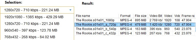

    Sample: The Rookie s01e01
    If I dl 432p or 540p the frame rate is 23.976fps and the bit rate is as predicted.
    If I dl 720p or 1080p the frame rate is 47.904fps and the bit rate is doubled.

      That's without vpn the same and affect only AV1, which is relative new in SF.

      Yes, we can reproduce the problem, and I will ask the dev to check it.
