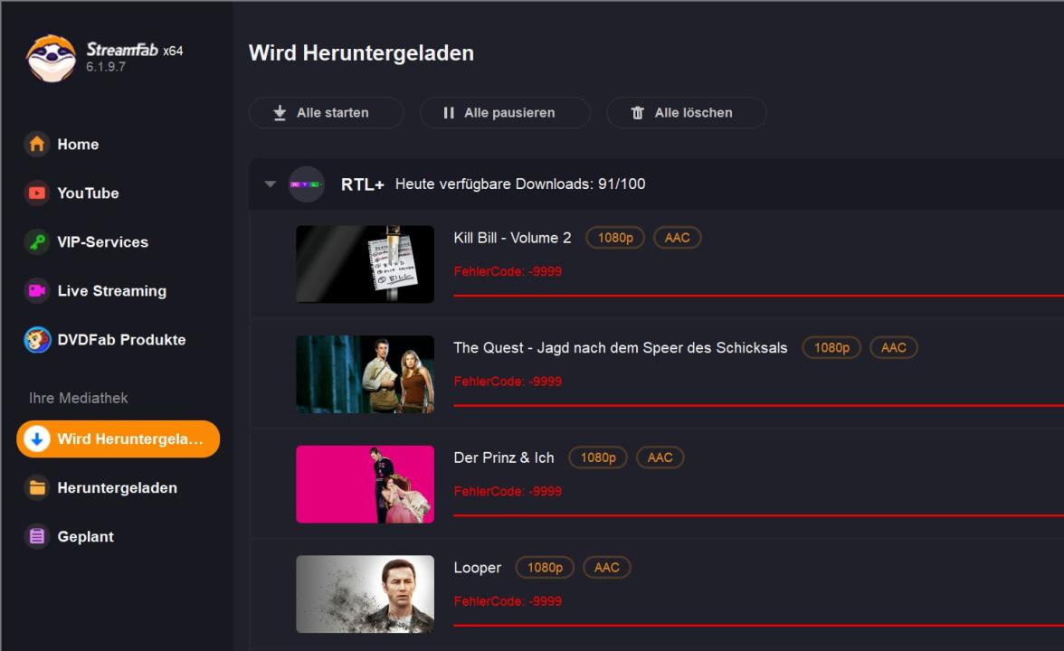

error code -9999
    RTL+ error code -9999
    Some downloads on RTL+ abort with the error code -9999. Wilson.Wang
    Click image for larger version  Name:	Screenshot 2024-09-10 152821.jpg Views:	0 Size:	63.7 KB ID:	450005

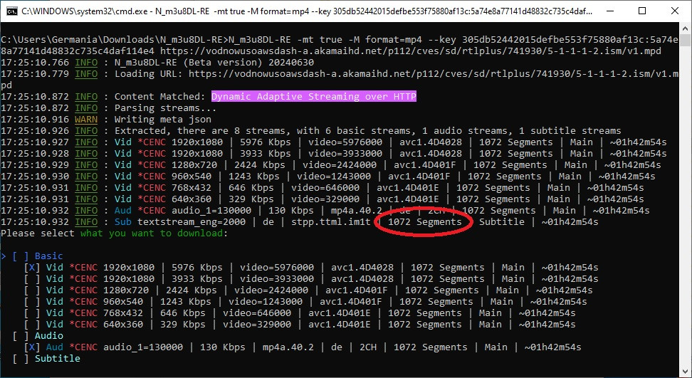

      .. the error exists because you select subs.
      The problem is that "RTL Plus Downloader" assumes that the subs have as many segments as video or audio.
      But this is not the case, as the subs usually end before the credits.
      The error is not caused by SF, but by the RTL+ manifest ..
      .. behaves the same with every MPD downloader.
      Example Looper - it shows 1072 segments for video, audio + subs:
      but there are only 979 segments for the Subs - manually Log
      N_m3u8DL-RE can fix this with "--check-segments-count:false"​

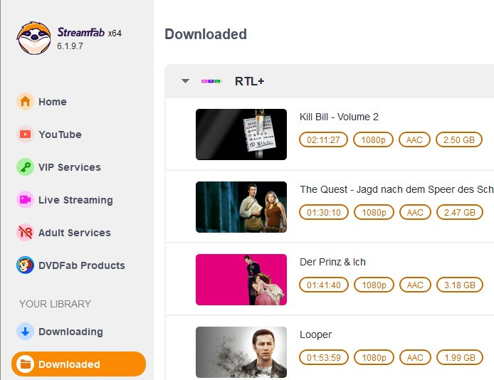

        After I received the information that no subtitles were selected, I tried again.
        No problem detected:
        So the question is: Why is SF downloading subtitles for you without selecting them?
        I don't have an answer at the moment - it doesn't happen to me​
          I will test it again....
            Fixed. Can be closed!
