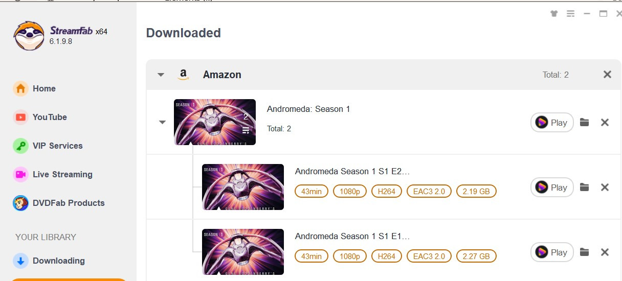

    I just tested and was able to successfully download some episodes in 6.1.9.8.

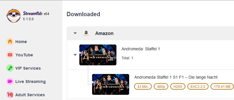

          I used the latest version 6.1.9.8 and 6.1.9.6 but same error code.
          log done and attached as suggested from cats4u.
          flylow+ sorry havent said that I use the german version of amazon video.
            There is no 720p at amazon.de - see in German Forum here
            Edit: Try "Extract to srt" instead "Remux Into File"
            from amazon.de H265 + EAC
